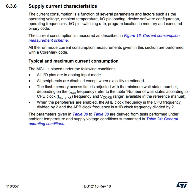

How to calculate the power consumption of STM32H743 from datasheet, theoretically as close as possible to the actual value? What parameters should be considered?
Also, I want to calculate the heat generated from MCU -- dissipated power (in W). How to calculate that?

You can never do an exact calculation - it will always be an estimate
The datasheet gives you power consumption figures - use them.
There is also a power estimator in CubeMX (standalone, or within CubeIDE).
Or use a dev board, and measure it.
PS:
https://www.st.com/resource/en/datasheet/stm32h743vi.pdf#page=110

You can also refer to AN5036 "Guidelines for thermal management on STM32 applications", see the section 6 Thermal analysis examples
