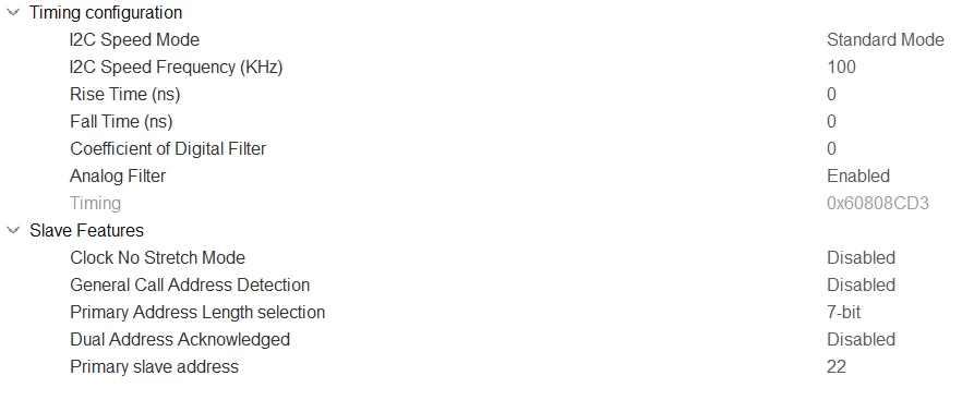

As of now i do a an i2c example working in standard mode, I am able to receive and transmit.

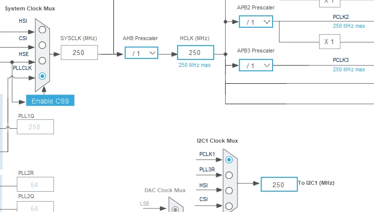

here are my settings: using i2c1
my clock configuration:
I would like instructions on how to get the timing above: 0x60808CD3

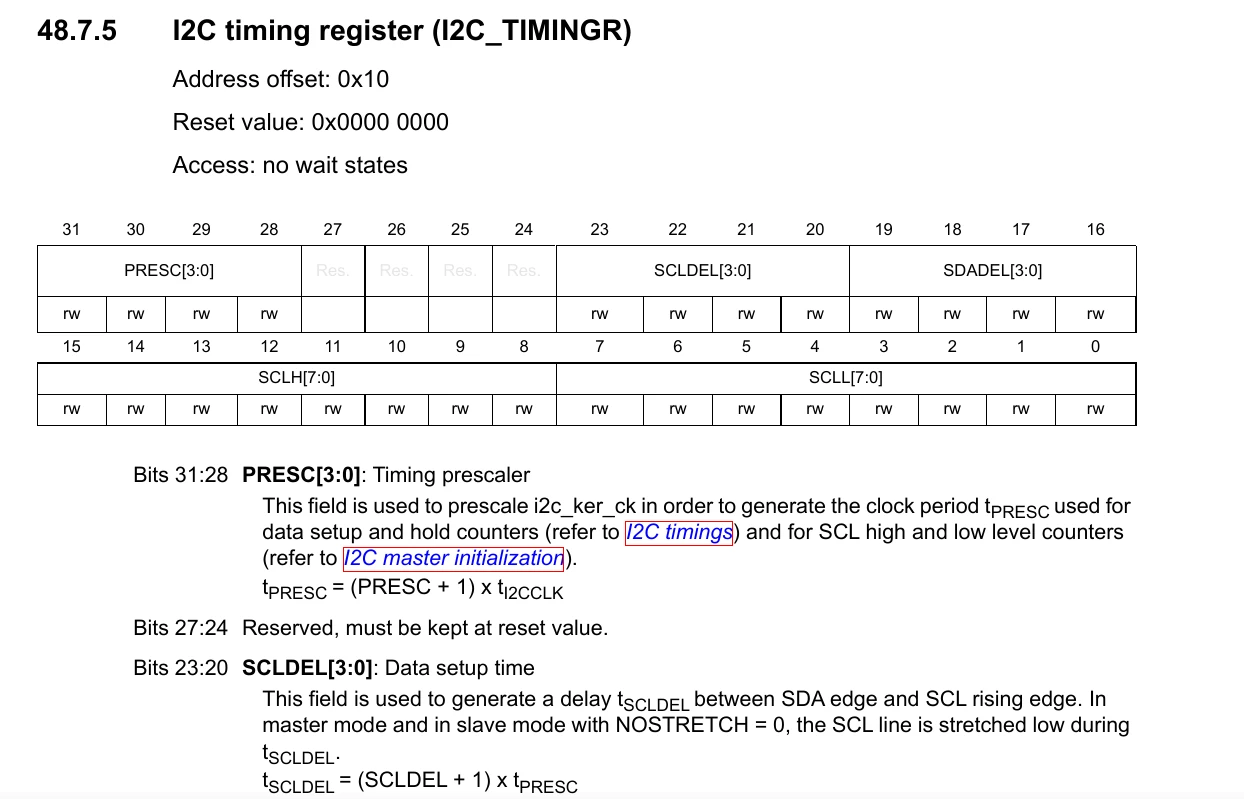

I have reviewed the Reference manual, but haven't had any luck with how it get's the values for SCLL, SCLH, SDADEL, and SCLDEL. Or the best rule of thumb with choosing the values.
here is the link to the RM: STM32H523/33xx, STM32H562/63xx, and STM32H573xx Arm<Sup>®</Sup>-based 32-bit MCUs - Reference manual
section 48 for ic2
Another question: SDADEL and SCLDEL does it calculate value every single time so on a different board (but with the same board) it might have a different value or would it be the same with the same chip.

i would recommend using Cube...its just for making life more easy.
But if want to go the hard way... take the rm and read...
1. the I2C module gets a clock...see in your clock tree, what you give to it.
2. it has an prescaler...set it.
3. then set the sck hi and lo times, to get the clock speed you want:
Take a scope and look, sending something on this I2C, what comes out...and adjust, as you like it to be.
i cannot understand...but if same clock tree setting on same chip type, same i2c timing will result, if same timing set.
