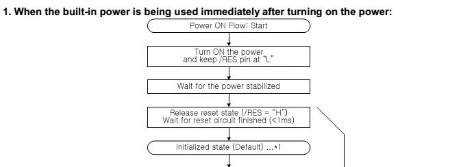

Hello everybody,
I communicate with a popular screen, the DOGM128 (ST7565RLCD Controller) with my STM32F4 uC. Sometimes, when I power on my board, the screen have troubles to be initialized (it remains white, whatever I do). I think it's due to the SPI speed, that I can't estimate. The max SPI clock speed of the screen controller is 20MHz. This is my SPI screen init :RCC_APB2PeriphClockCmd(RCC_APB2Periph_SYSCFG, ENABLE);

With SPI_BaudRatePrescaler_2 : The screen works almost everytime
With SPI_BaudRatePrescaler_4 :The screen works half the time
With SPI_BaudRatePrescaler_8 :
The screen never works
So how can I increase the SPI speed, in order to try to solve my problem ?
