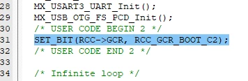

I'm implement IAP in Nucleo-H745ziq.
So. when i into application then cm7 trigger(boot) to cm4.
cm4 can't boot in keil but in stm32CubeIDE can boot.
SET_BIT(RCC->GCR, RCC_GCR_BOOT_C2);

This doesn't work either.
I'm check already flash cm7 boot addres
HAL_RCCEx_EnableBootCore(RCC_BOOT_C2);
STM32CubeIDE Application Projcet it work cm4
But keil Application Project can't boot cm4

I'm tried again Today in STM32CubeIDE.
First. I'm made new Application Project.
CM7 in main.c I'm code just one line SET_BIT(RCC->GCR, RCC_GCR_BOOT_C2);
But I can't boot cm4.
However, I'm tried Changed CM7 timer TIM4 from SYSTICK
Then CM4 can boot.
You know why that worked?
Now, My Keil application project can trig boot for cm4
