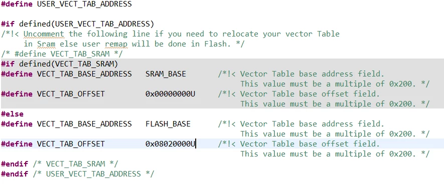

Did you set the vector table according to that new address?
Did you update the linker file according to that new address?
May 16, 2025 1:15 PM UTC
Yes i done these steps:

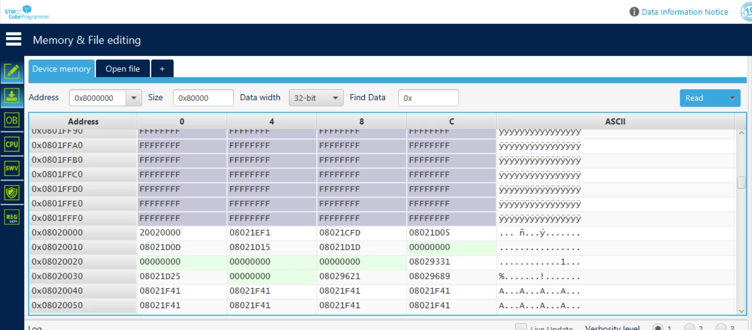

I placed the code succesfully @sector5 (i.e., 0x08020000) , but it runs only once , after reset it doesn't run.

STOne-32Best answer
May 17, 2025 9:11 AM UTC
Dear @Shreayas_Acharaya ,
You can not boot at sector5 on this product, impossible , it is hardware coded to either Flash sector 0 or ST system memory boot .
So, if you want to do that , you need to program a Jump code from Sector 0 to sector 5, therefore programming First boot sector at 0x0800-0000. When using debugger , the debug is forcing that jump automatically but this will not happen at standalone after cold reset.
Cheers,
