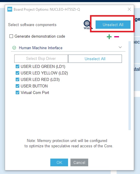

How to Blink onboard LED on a NUCLEO-H755ZI-Q WITHOUT using BSP - only HAL?
Have got the NUCLEO-H755ZI-Q board with the STM32H755ZI chip on it and able to use the BSP package and drive the three LEDs and also perform debugging.
However, whenever tried to build a new project and select STM32H755ZI (not NUCLEO-H755ZI-Q) and configure the project based on the settings in NUCLEO-H755ZI-Q the code does not run. Nor is debugging possible. Also, used the neat Compare Projects tool; but nothing that would impact it stood out.
Have already looked in this online ST-forum and the https://github.com/STMicroelectronics/STM32CubeH7/tree/master and cannot find a simple example of configuring a blinky for a this dual-core or any other - that does not rely on BSP.
All is needed are snapshots of the STM32CubeMX setup.

Hello @smallkitties3 and welcome to the community,
Simply, click on "Unselect All" button to prevent CubeMx to generate the BSP code and configure the GPIOs according to your needs.
I've attached a project where Green, Red, Yellow leds are toggling on NUCLEO-H755 board. The project was generated with CubeMx v6.13 starting from a the board (Bsp generation disabled from the beginning).
Hope that answers your question.

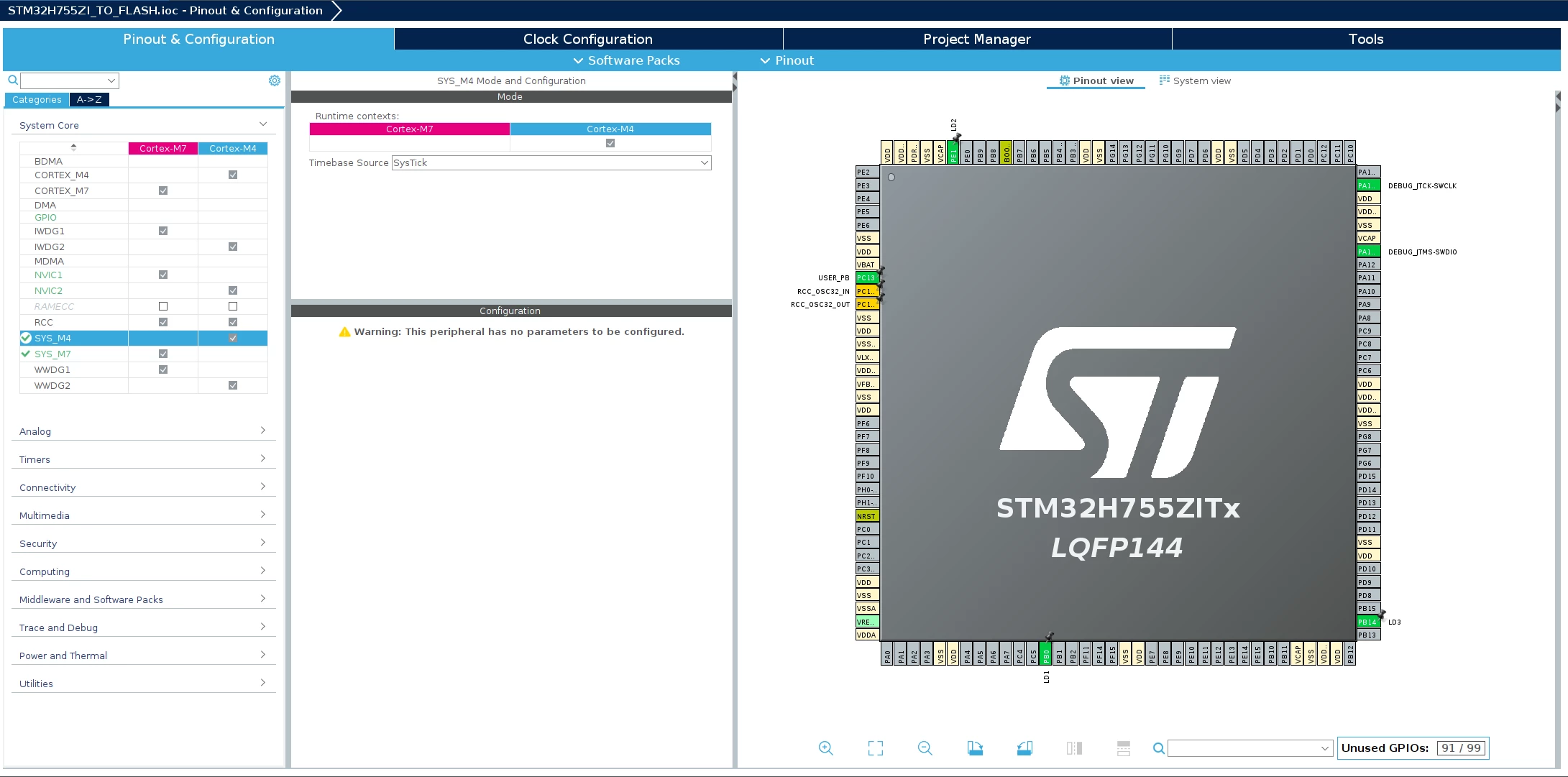

Dec 23, 2024 9:06 PM UTC
Hello gdm,
To answer your question, I expected snapshots of how to configure CubeMX for the STM32H755ZI to do a simple blinky of either of the embedded LEDs.
My Configuration already has: (see CubeMX attached snapshot)
1) The three LEDs selected
2) In RCC, the HSE & LSE were disabled and the HSI RC is configured in Clock Configuration
3) Both SYS_M4 & SYS_M7 are using SysTick for the Timebase Source
Not sure what "add[ed] 4 lines of code to SysTick ISR" you're speaking about as that was not required when using the BSP. Code Generator already took care of those settings.
Thank you for your reply.
