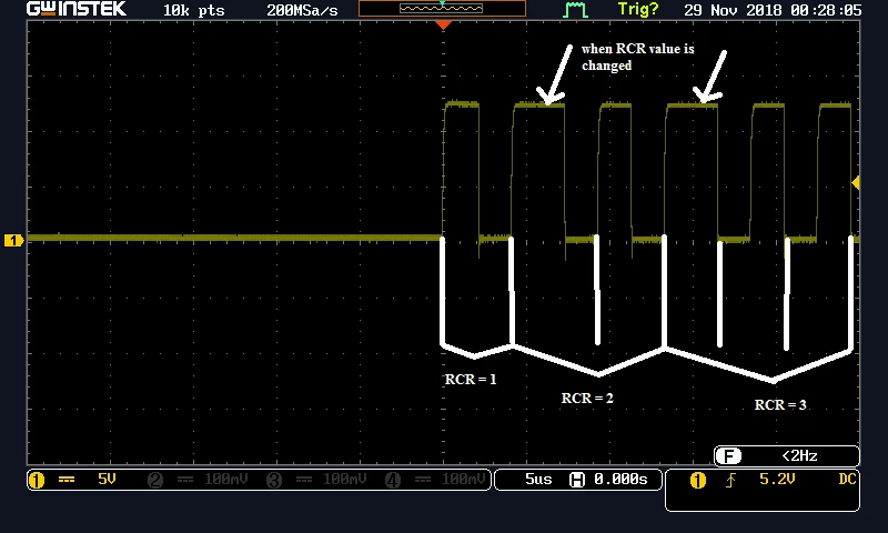

I am developing a motor control application for a servo that is controlled in impulses. So, in my case, the number of impulses represents the number of steps.
For that, I am using the TIM1 in PWM mode using One-Pulse. To account for the number of steps/impulses I use the RCR. To change the RCR val I set the corresponding bit of EGR to generate an update of the TIM1 registers.
The problem arises when I want to generate a small PWM period (4 us in the figure above) I have created a small trial application to test the functionality of my approach. So, I am generating 3 sequences of impulses using 3 different values (0, 1 and 2) for RCR. Because the RCR val corresponds to RCR+1 pulses, the result has to be 6 impulses, which is achieved. However this result is not good because when the RCR value is updated, a delay is introduced. See the picture below.
0690X000006CXTiQAO.pngTo accomplish this task I used interrupts for update events, namely:
  1. When the RCR value is updated, do nothing in interrupt. Only needed to update TIM1 registers.
  2. When the RCR value overflows, that means the present sequence of impulses finished, so I change the value of RCR and I update the EGR register (which generates the above event).

Finally, I somehow would like to update the RCR and TIM1 registers without treat the first update interrupt from above. I belive, there I lose time...
Thank you for your attention and I look forward for some advises. Se the code from interrupt service routine below:
