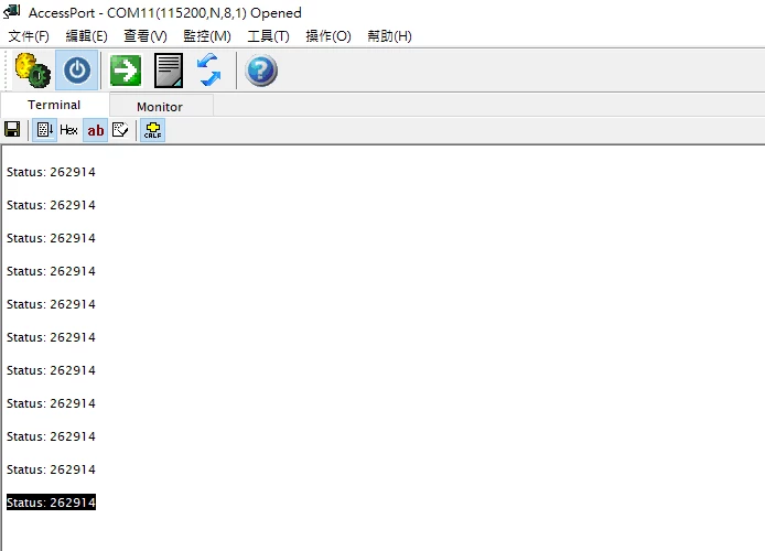

How to apply SPI between ESP8266 and STM32f07 with FreeRTOS ?
Recently, I've been worked with the esp8266 and stmf407 discovery board.
I used stm32f407 (master), and connect to esp8266 (slave) via SPI
However, the package I got always missed 1 package. To be more specific, I've tried to send some uint8_t dummy datas, but all the results i got always had a missing part.

// I sent SPI_data[4]={0x01,0x02,0x03,0x04} through stm32f407 (master)
// esp8266(slave) debugging return from Arduino
0693W000006HAnaQAG.png// Nevertheless, the result i got is {0x00, 0x04, 0x03, 0x02}
TDKBest answer
Dec 30, 2020 2:13 PM UTC
The code you're using to send SPI is fine.
The bytes are reversed because the Arduino stores them blindly as they are received and then reads them back in little-endian.
i'm pretty sure the first byte (0x01) is lost because it indicates the status register, although it's quite hard to trace the logic in the Arduino code.
