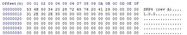

    Hello, I'm using ARM GCC and I'm trying to use linker script as below:
    MEMORY
    FLASH_ISR_TABLE (rx) : ORIGIN = 0x8000000, LENGTH = 16K
    FLASH_DEV_DESC (rx) : ORIGIN = 0x8004000, LENGTH = 16K
    FLASH (rx) : ORIGIN = 0x8008000, LENGTH = 1024K - 32k
    CCMRAM (rwx) : ORIGIN = 0x10000000, LENGTH = 64K
    RAM (rwx) : ORIGIN = 0x20000000, LENGTH = 128K
    SECTIONS
    .isr_vector :
    KEEP(*(.isr_vector))
    } > FLASH_ISR_TABLE
    .device_desc :
    KEEP(*(.device_descriptor))
    } > FLASH_DEV_DESC
    .text :
    *(.text*)
    KEEP(*(.init))
    KEEP(*(.fini))
    /* .ctors */
    *crtbegin.o(.ctors)
    *crtbegin?.o(.ctors)
    *(EXCLUDE_FILE(*crtend?.o *crtend.o) .ctors)
    *(SORT(.ctors.*))
    *(.ctors)
    /* .dtors */
    *crtbegin.o(.dtors)
    *crtbegin?.o(.dtors)
    *(EXCLUDE_FILE(*crtend?.o *crtend.o) .dtors)
    *(SORT(.dtors.*))
    *(.dtors)
    *(.rodata*)
    KEEP(*(.eh_frame*))
    } > FLASH
    In the map file I look up the
    __isr_vector
    .isr_vector 0x08000000 0x18c
    *(.isr_vector)
    .isr_vector 0x08000000 0x18c ./Src/startup_STM32F40XX.o
    0x08000000 __isr_vector
    .device_desc 0x08004000 0x18
    .device_descriptor
    0x08004000 0x18 ./Application/SKP4_revA_Main/SKP4_MainApp.o
    .text 0x08008000 0x36678
    *(.text*)
    At this stage everything looked ok (at least for me:) ) But when I checked hex and bin file the __isr_vector was missing. (Output files started from string descriptor which I put in .device_descriptor section. This section start from address: 0x8004000)
    When I modified
    isr_vector section as follow:
    .isr_vector :
    *(.text.SD*)
    *(.text.*Handler)
    > FLASH_ISR_TABLE
    Problem disappear. Output files starts from ISR table as they should. And program runs under debugger without any problems.
    Any ideas why linker is removing
    isr_vector section even if its marked as
    KEEP???

    kkawula
    June 18, 2014
    Posted on June 18, 2014 at 10:16
    Sorry I forgot to include it, now is in attachment.
    Once again thanks for Your help.
