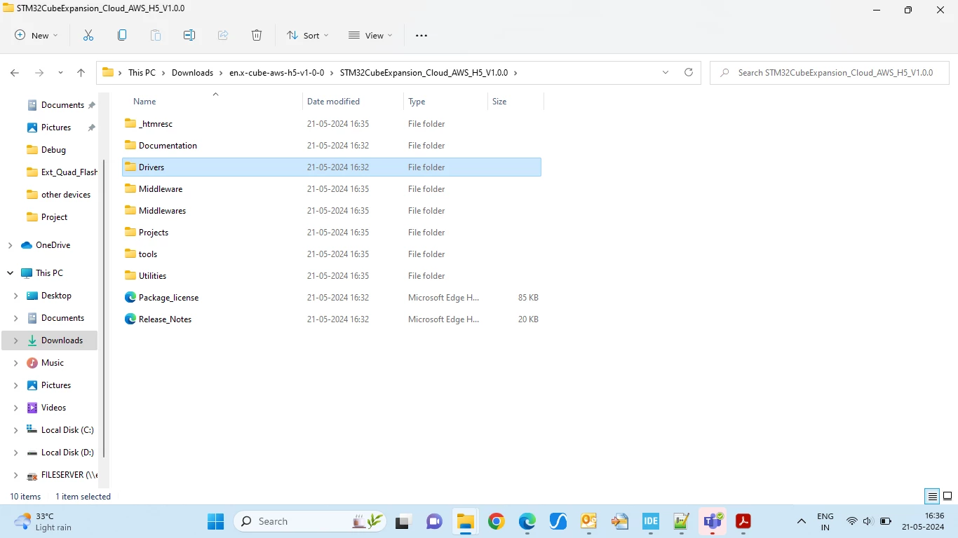

After downloading the X-CUBE-AWS H5 extension, I am seeing the below files. How do I find library file to add it cube IDE?
