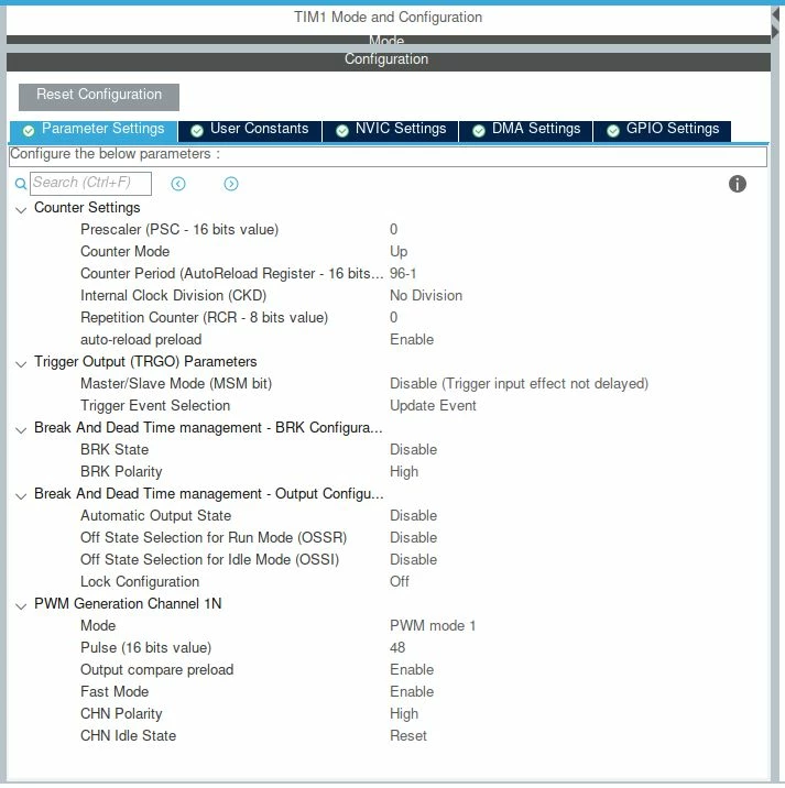

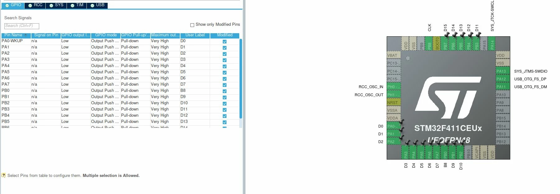

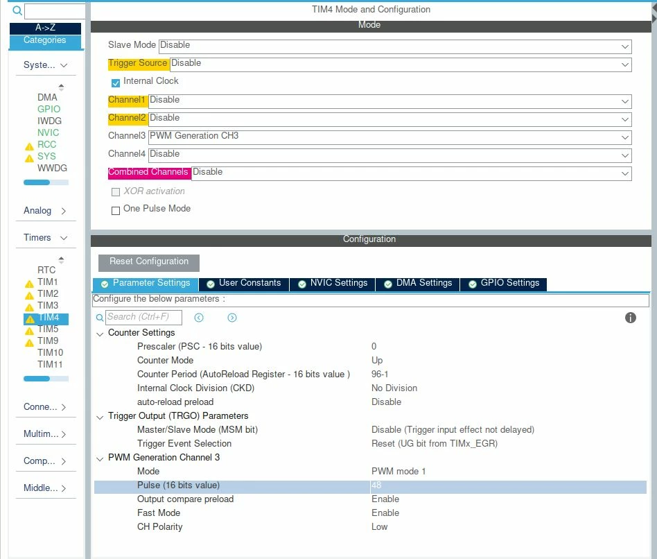

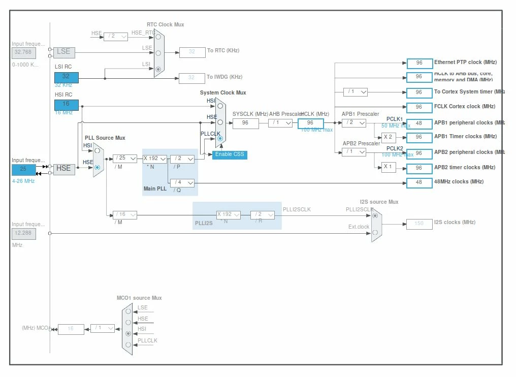

I need your help, I am interfacing 16-bit DAC LTC1668 50MHz with STM32F411CCU6.
I have used Timer 4 as 1MHz CLK for DAC, on Half Pulse Complete interrupt I update the GPIO Port (Port A A0-A7 are D0-D7, Port B B0-B7 are D8-D15). But Facing problem as the Data on the ports take 3 to 4 CLK cycles to change. As I lower the CLK to 275KHz the Data on ports changes before the next cycle. How can I make it change before the next cycle in higher frequencies say 5MHz to 10MHz.
For Sinewave Data points are generated through python program, further these data points are being transfered through USB, But now I am stuck here.
I have attached RCC CLK configs, Pin configs, Timer Configs. I can share more details if needed.
Here is the code for Timer Interrut Routine:-
const uint16_t pypoints[2750] = {32768,33516,34264,35012,................30523,31271,32019};
int k = 0;
void HAL_TIM_PWM_PulseFinishedHalfCpltCallback(TIM_HandleTypeDef *htim) {
	GPIOA->ODR = (uint32_t)(pypoints[k] & 0xFF);//LSB
	GPIOB->ODR = (uint32_t)((pypoints[k] >> 8 ) & 0xFF);//MSB
	k++;
	if(k >= 2750)
		k = 0;

October 10, 2023
Using DMA is going to be the best way to achieve this. You can set up two channels of a timer to trigger at the same time and transfer a byte into GPIOx->ODR.
Using interrupts at speeds of 1MHz+ is generally a nonstarter, especially with HAL.

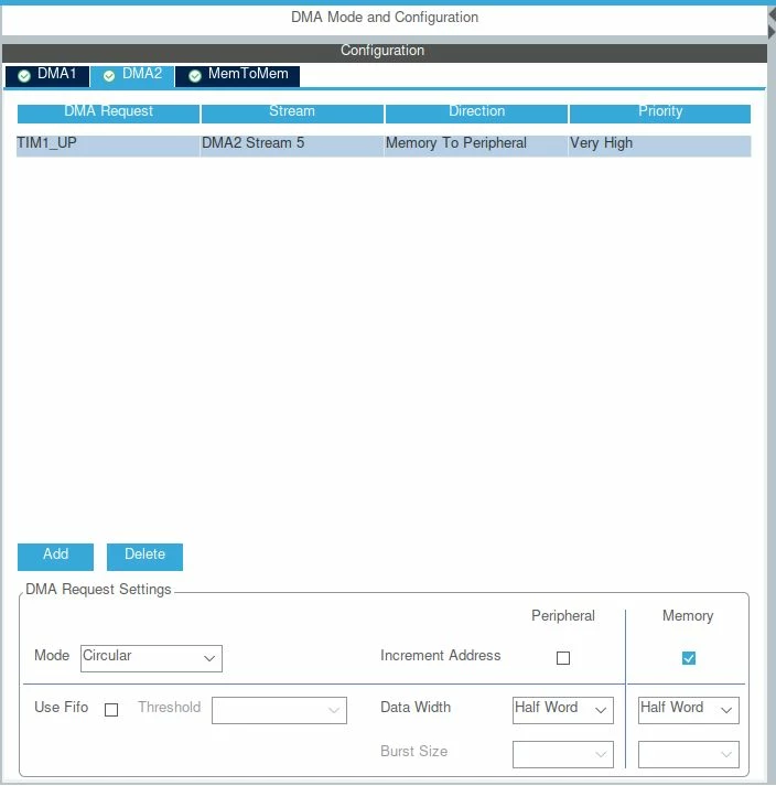

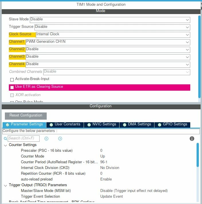

I have tried DMA1 config as Memory to Periperal with Timer 4 config as PWM gen using its Update Event to transfer data byte to GPIO Port A but that didin't worked. I debuged and found that Timer PWM was working but it doesn't trigger DMA or may be some problem with DMA1.
Than, I tried DMA2 config as Memory to Periperal with Timer 1 as PWM gen using its Update Event to transfer data half word to GPIO Port A used complimentary output as DAC CLK and that worked. But unable to go more than 1MHz (Ticks = 96) as I go lower (Ticks = 72) I didn't even got PWM Output.
Here is the code:-
int main(void)
 HAL_Init();
 SystemClock_Config();
 MX_GPIO_Init();
 MX_DMA_Init();
 MX_TIM1_Init();
 /* USER CODE BEGIN 2 */
 HAL_DMA_Start_IT(&hdma_tim1_up, (uint32_t)pypoints, (uint32_t)&(GPIOA->ODR), 100);//Interrupt Ensure that data is transfered
 HAL_TIM_Base_Start_IT(&htim1);
 HAL_TIM_PWM_Start_IT(&htim1, TIM_CHANNEL_1);
 HAL_TIMEx_PWMN_Start_IT(&htim1, TIM_CHANNEL_1);
 TIM1->DIER |= (1 << 8);// set UDE bit (update dma request enable)

Thanks for your reply.
I am using STM32F411CEU6 and configured the TIM1_CH1 to trigger DMA2 to transmit data through GPIO. The TIM1 is just generating a PWM signal for the output clock of 10MHz. I have put all pins in GPIOA so I can use a half-word data width on PSIZE and MSIZE data width is a byte with FIFO Enabled (Full Threshold).
