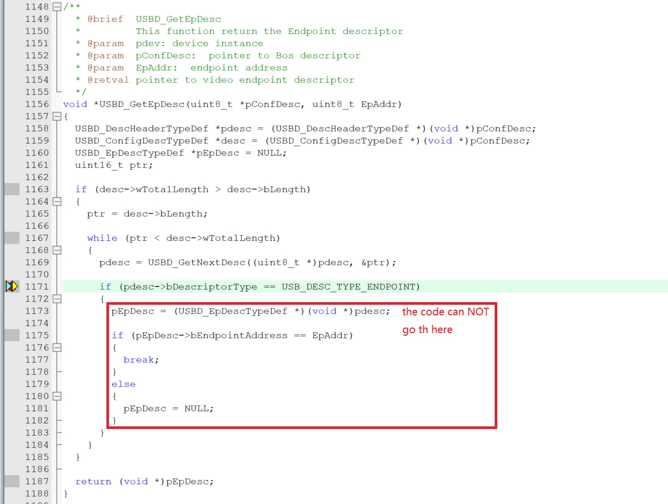

Hi there,
I am working on STM32F429BIT6, and I have a SD-Card connected.
Now, I want to copy some data between the PC and SD-Card by USB directly.
Is there any example or document?
Anything is welcome, thank you!

There should be a MSC USB Device example amongst those ib CubeF4, perhaps as Applications for EVAL or DISCO series boards that map operations to SDIO port.

I find a example similar with my requirement at STM32Cube_FW_F4_V1.28.0\Projects\STM32F412G-Discovery\Applications\USB_Device\MSC_Standalone, I will read it carefully.

I have read the example and this tutorial carefully.
But my program always can't work, the code is stopped at USBD_GetEpDesc() because pdesc->bDescriptorType always NOT equals to USB_DESC_TYPE_ENDPOINT
I am not skillful at USB, but I can sure the hardware is work well, as I have a project can do that thins.
If need, refer my project at attachment.
Thanks for your help!

For MDK IDE, the USB related code must compiled by "MDK compiler V5", the binary by "MDK compiler V6" will NOT work!
Demo reference: https://github.com/ShadowThree/STM32V6_extFlash_SDcard_FatFS_Udisk_Demo
