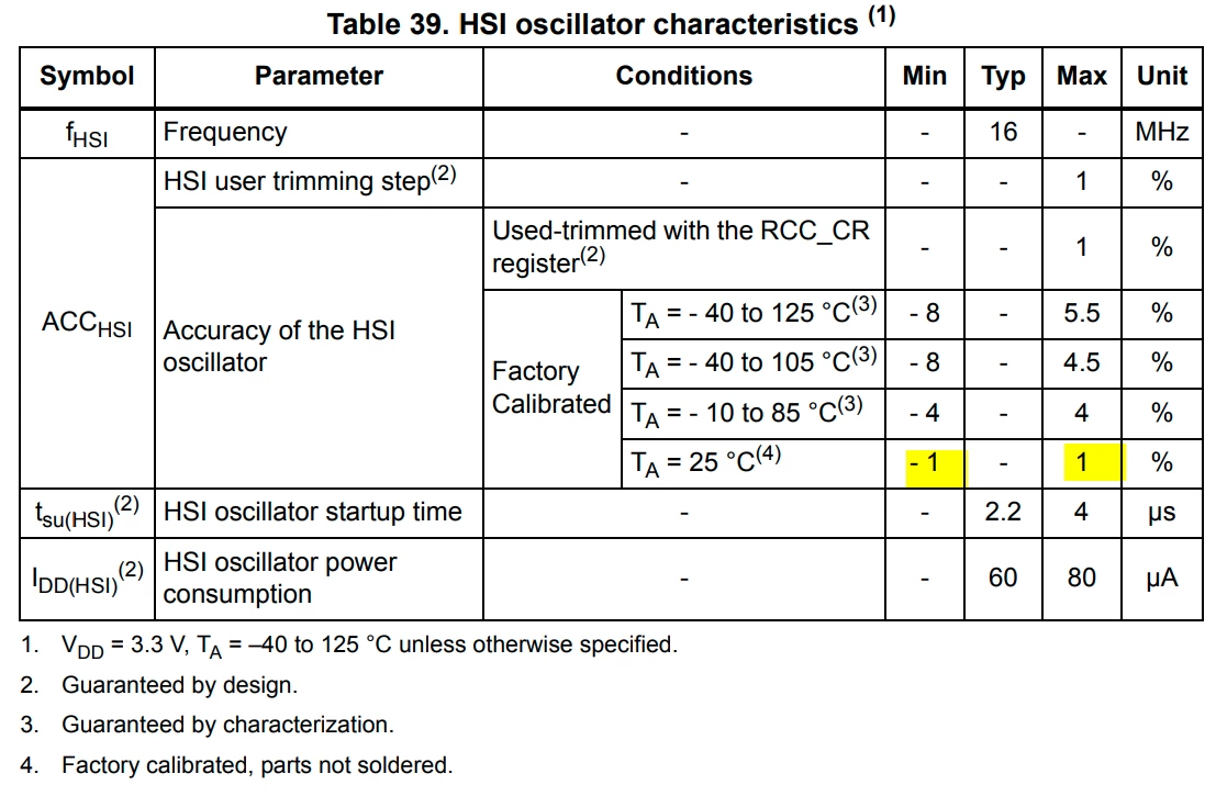

I tried using CubeMx, but only for PLL config. In my code that is fine, but when i try to generate a delay of lets say for eg 1ms i get output of only 981 microseconds. Due to this mismatch i think entire delay is changing. Can it be due to HSI.
August 25, 2023
Yes, absolutely. You're seeing an error of 1.9%. Let's check the datasheet for the HSI:
So it guarantees ±1% at ambient before part is soldered. Soldering will change that some. You can adjust the HSI using HSITRIM to get it more accurate.
If you need good accuracy, crystal+HSE is going to be much more accurate.
Also be aware ARR is preloaded and there's probably better ways to do delays, but that is a side issue.
