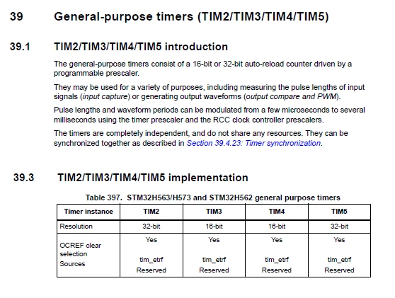

How many 32 bit timers does STM32H573 have? 2 or 4? Conflicting information in data sheet
I'm refering to DS14121 Rev 1 of STM32H573xx.
- "Figure 1. STM32H573xx block diagram" shows 4 32 bit timers (TIM2, TIM3, TIM4, TIM5)
- "Table 2. STM32H573xx features and peripheral counts" says there are only two.
Where can I find trustworthy information on the correct number?

From RM0481:

From RM0481:

Yes indeed it's a typo and it will be fixed in coming revisions of the DS. Thank you for raising this up :).
Internal ticket number for tracking: 168793

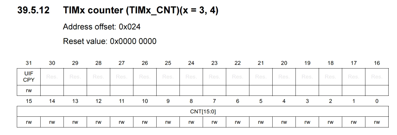

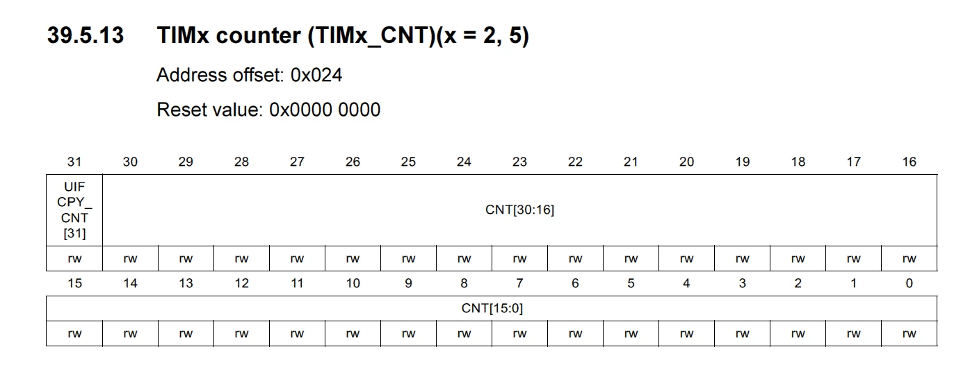

where are the missing 2 x 32 bit counters?
tim2 + 5 are 32 bit:
tim 3 + 4 are 16 bit:
and where the other 32 bit counters ?

OK. Now it's clear. It  will be fixed in coming revisions of the DS. It will be treated in the same ticket number: 168793.
