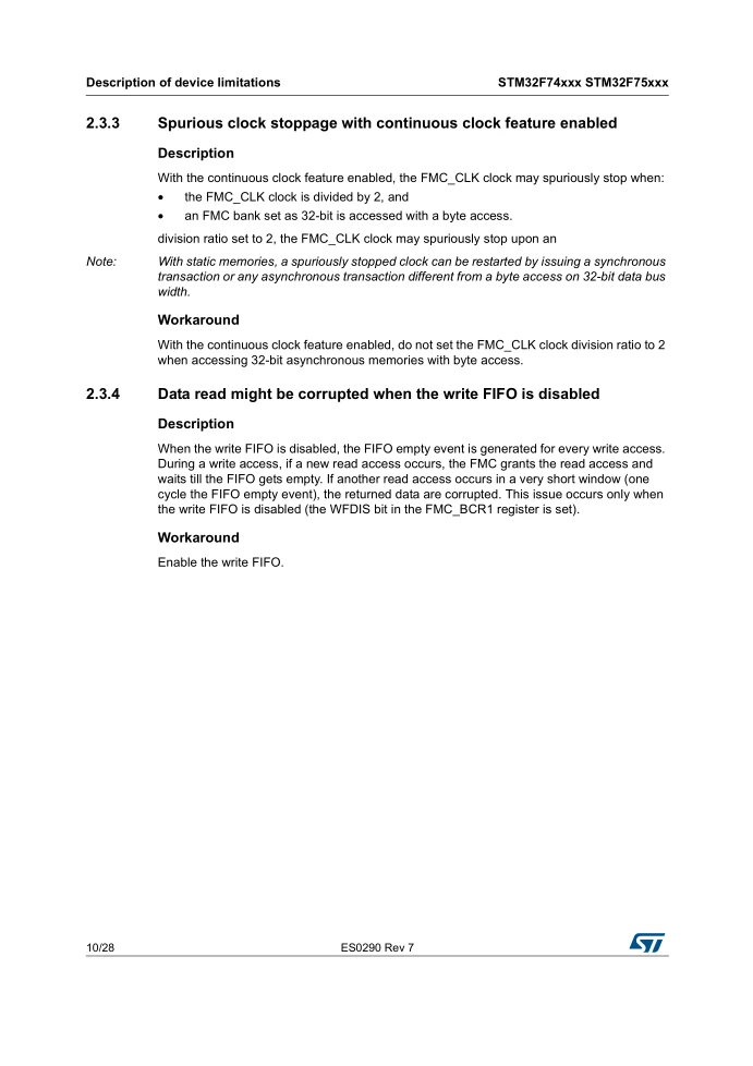

Without a clear, simple code accompanying the images, hard to draw definitive conclusions.
But look at this erratum:
I know it's 'F7 and not 'F469, and I know it's not in the 'F469 erratum (which currently is quite fresh, dated Oct.2019), but they appear to have a similar FMC, and they came out at around the same time.
At this point, you may want to contact ST directly, through the web support form, or through FAE.

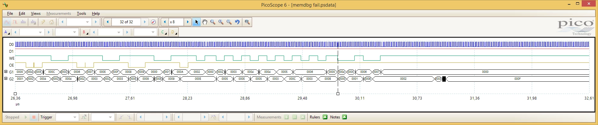

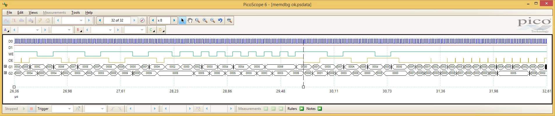

The SRAM is a IS61WV204816BLL-10BLI
I have attached two dumps of the bus activity. I only had access to the lower 4 bit of address and data, and no access to the RAM chip select. The speed is at the limit of the bandwith of the analyzer, hence the small deassertion of eg WE when writing two 16 words are not shown.
The first image shows a scenario where there is the expected read, and the right value is available in the register.
The marker is set where the read is performed. The values 0008 & 0001 is read which matches the lower bits of the expected value.
This image shows a scenario where there is no read.
The marker is placed at the location where the read should have taken place.
The data on the bus is similar on both images up to the marker.
The only difference on the two situations is that i have enabled the FIFO write in the first run, and disabled it in the second.
It should be mentioned that i tried to slow down (factor 2-4) the AHB clock in order to verify the missing WE deassertions. They showed up nicely and the problem was still there.
But when I enabled the write FIFO the code took a different path, and I was not able capture a comparable flow

Thanks.
It sounds very much like the issue we are facing.
I'll contact ST.
