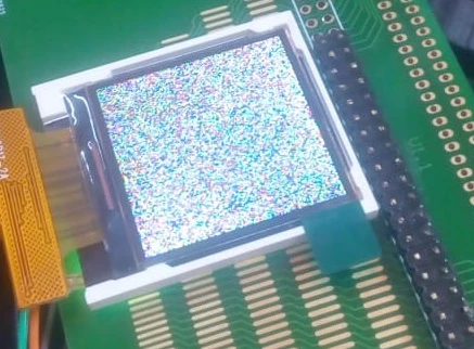

sir,
sorry for the late reply.
I am using display with ST7735S as driver and it is having green tab. I have set the SPI as required. I have attached my code here. I started to code the display with filling pixels with some colors. the display is now showing mixed colors.
i don't know whether the problem is in the initialization command or in the code for the pixels.
can you help pls

this is my display now
RomainR.
Dec 31, 2018 5:49 PM UTC
Here archive attached of my code for STM32L476 with cheap 1.8" LCD ST7735.
You can port the code on F4 easily with Cube (.ioc)
NSS (CSX in my code) is managed by software (not SPI hardware)
Here SPI2 config for CPOL/CHPA with SPI frequency = 10MHz.

AANTO.13
AANTO.13Author
Jan 2, 2019 10:46 AM UTC
sir,
thank you for helping me.
I could not load the code since I have the updated version of cubemx.
I do have another doubt also
I have ST7735S display with Green tab
I used initialization in my code as below

will the initialization changes for ST7735S display like ST7735R as the tab color changes?
RomainR.
Jan 2, 2019 2:21 PM UTC
"will the initialization changes for ST7735S display like ST7735R as the tab color changes?"
You need to check the datasheet of your ST7735S display and check cmd register.
I do not understand why you're not able to my project with CubeMX ?
