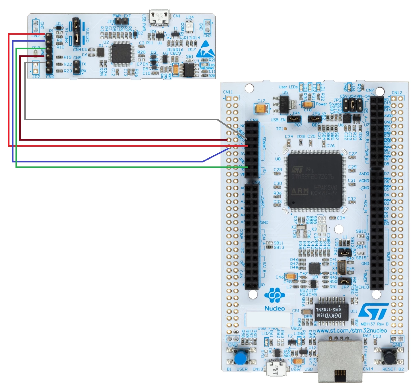

How is it possible to power the Nucleo-144 board with an external NEGATIVE power supply (VDD= 0V, VSS= -3v3)?

    Jun 21, 2021 9:44 PM UTC
    Voltage is relative. As long as VDD - VSS = 3.3V, it will work. However, if you have other things connected to the board that think VDD = GND, you're going to have issues.
    Information on powering the board from 3.3V is in the user manual:
    https://www.st.com/resource/en/user_manual/dm00244518-stm32-nucleo144-boards-mb1137-stmicroelectronics.pdf

    0693W00000BbbqgQAB.pngAccording to Table 7 (page 19) and paragraph "External power supply input: + 3.3 V" (page 23), there are two possibilities:
    - ST-LINK PCB is cut
    - SB3 and SB111 OFF (ST-LINK not powered)
    So my question is: If I cut the ST-LINK/V2-1 PCB from the board, is it possible to use the ST-LINK/V2-1 (removed) to program and debug the same board (I removed from)?
    According to Table 5 (page 22) and STM32CubeMX:
    VDD_TARGET --> 3V3
    SWCLK   --> PA14
    GND    --> GND
    SWDIO   --> PA13
    NRST    --> NRST
    Is it correct to connect the pins as shown in the picture?
    Jun 22, 2021 12:36 AM UTC
    Yes, it is. Note that the programmer and the board will need the same ground. I'm unsure if SWDIO/SWCLK are broken out into pins somewhere, but provided you can get at those somehow, you can program the board.
