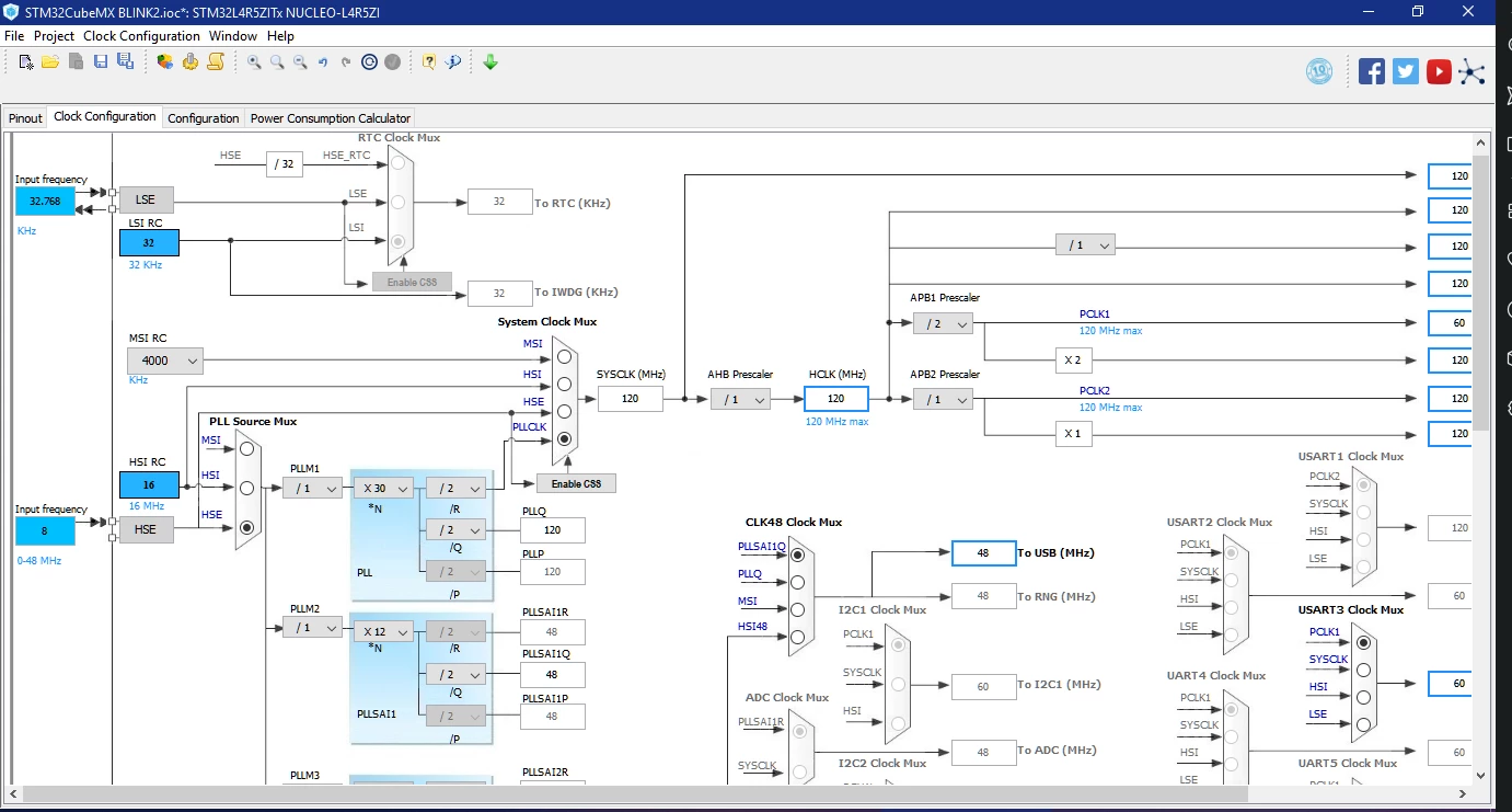

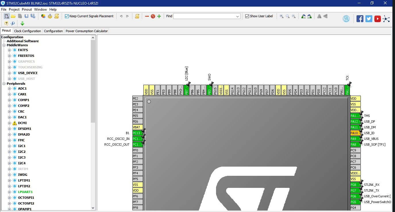

hello team,
I am trying to get started with NUCLEO l4r5zi board.
The first program i am doing is to blink a LED on board (PB7) .
Problem is the program builds successfully and is loaded on the board . but the LED is not blinking.
Moreover the Console reads a breakpoint on MX_INIT_GPIO.
Please guide me with the procedure to perform this .0690X000006C2w3QAC.png0690X000006C2wDQAS.png

I also surfed for the similar post, where I got an thread which stated to change the clock from HSE to HSI / MSI . but It didn't work for me.
September 19, 2018
Check the VDD_MCU, as LD2 (which is connected to PB7) cannot work with VDD_MCU= 1.8 V.
Kind Regards,
Imen
jesal.patel
September 20, 2018
Hello Imen,
Thank you for guiding.
The device is powered by USB.
I could now succesfully perform the blink program.
