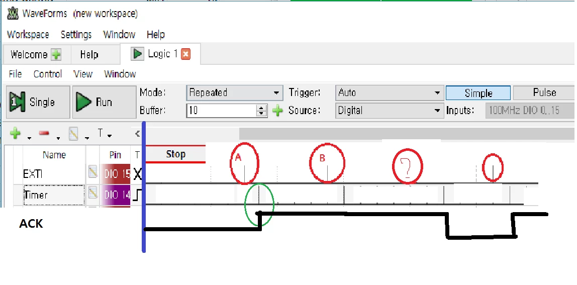

Currently, I'm trying to implement the Timer to the EXTI.
Especially, I'd like to watch the toggle input signal by EXTI in limited time.
and I want to make a ACK signal like the following image
If I set the count 3 toggle signal but real input signal is 2 then turn on the Timer then what if there is nothing toggling signal in limited time then I want to make ACK is 0.
So I've implemented the Timer which was I could set the time period.
But the problem is my implementation is suck and kill me.
I need your help. How do I implement
watching to the periodic  toggle input signal by EXTI in limited time ?
If input toggle signal active high while in limited time, then I want to set ''ack'' to 1, if not ack to 0.
Could you please help me how do I implement this?

The needed generated signals and valid trigger is a bit fuzzy to me.
