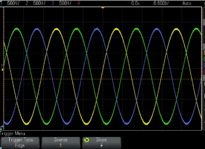

How does the Timer - DMA - Look up table to DAC index get set? Is it possible to change the index
I have a project where I'm using a Nucloe G474RE to produce a sine wave, all is working great; I have an array of 2500 values which produce a SINE wave starting at 0 degrees; I would like to add 2 further Sine waves starting 120 and 240 degrees later.
To do this, I could create 2 additional arrays with the values shifted to reflect the 120-degree and 240 degrees shift, but I was wondering whether I could use one array and produce the remaining 2 arrays by preloading the index the timer produces for phase 2 and 3 , indexing, reading and sending the value to the 2nd and 3rd DAC output.
Is this achievable
Thanks for any guidance
Nick

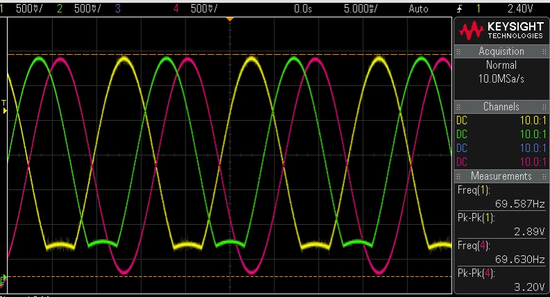

Hi All,
I have a further query about the DAC output for this that is puzzling me,  I have 3 sine waves all DAC conversions triggered correctly  but I seem to have lost the bottom portion of the sine 1 and 2 ( these are on the same DAC) ,  it was working fine until I connected the output of this on pin PA5 and PA6 to the input of an OPAMPS,  I think I have somehow damaged the buffer that I'm using inside the STM32 and it no longer outputs the full swing in voltage.
Here's a screen grab of the scope for the 3 phases.  Has anyone seen this before?  and is it possible to calibrate the output to correct it?
Thanks
Nick
