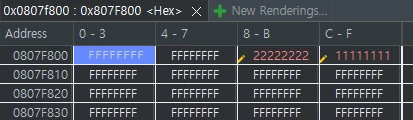

Here is the memory map of my test case:
0693W00000YAn2MQAT.pngData: 0x1111111122222222
Addr: 0x0807F808
As you can see, the data has been successfully stored in the designated address but I can't find where the ECC is.
It is quite confusing for me.
If I want to store new data after the data which I already write, should I leave 8-bit for the ECC Code? or should I just write right after where the previous data ends?
I think I am not on the right track :'(
Where the ECC Code stores in the flash memory?

The ECC data is stored in bits which are not visible to you. You will only see the 64-bits of user data in the Flash line stored in the array. From a user perspective you'll see contiguous blocks of 8-bytes as you wrote them.​

By the way, shouldn't the ECC data be in the flash memory somehow?
how can they be invisible although I can access almost every memory address?
I cant find any mention about that in the reference manual and other documents I can search.
Is it in the memory which is marked as "Reserved"? is that correct?
