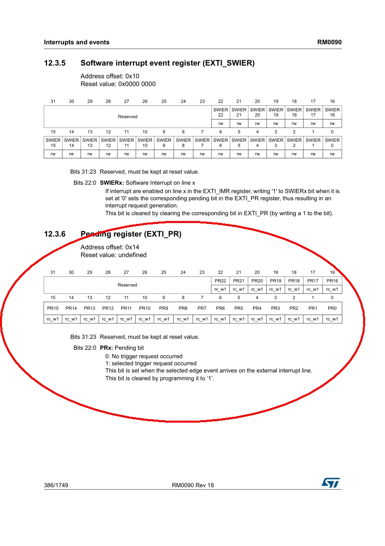

How do you differentiate GPIO interrupts that share the same EXTI interrupt?
Hi, I have a design where I have multiple GPIO interrupts and some share the same interrupt input line, for example EXTI10_15. How can I differentiate in the interrupt callback routine which GPIO triggered the interrupt aside from reading these GPIOs' input states?

They should flag individually, and OR together to generate the IRQ
Check EXTI->PR register (on F4 for example)

Thanks, that's really helpful.
