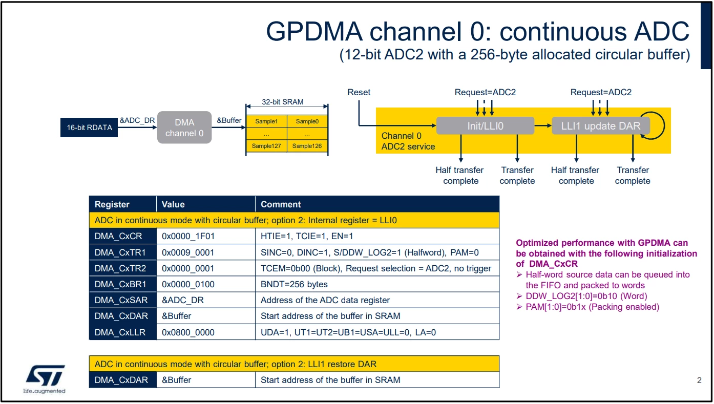

I am looking for a way to set up DMA to transfer from peripheral to circular buffer triggered from Timer
I hoped I could set it up just like it is described here, just change the source:
It samples data as expected but only once, it does not repeat when all 256 samples are taken.
Do I understand that picture wrong or is it bad? Do I need to do some more settings?
So my code looks like this:

It needed some more parameters.
In the Reference manual, it was described, but that DMA presentation paper was very misleading. And even that description in the reference manual is somewhat cumbersome.
This works as expected.

	GPDMA1_Channel0->CBR1 = GPIO_DMA_SAMPLE_BUFFER * 2;
	//Source GPIOC
	GPDMA1_Channel0->CSAR = (uint32_t)&(GPIOC->IDR);
	//Destination Sample buffer
	GPDMA1_Channel0->CDAR = (uint32_t)gGPIO_DMASampleBuffer;
	//Circular buffer mode
	GPDMA1_Channel0->CLLR = DMA_CLLR_UDA;
	//Setup Linked List
	GPDMA1_Channel0->CLBAR &= 0x0000FFFF;
	GPDMA1_Channel0->CLBAR |= (uint32_t)&DesttinationAddress & 0xFFFF0000;
	GPDMA1_Channel0->CLLR |= (uint32_t)&DesttinationAddress & 0x0000FFFC;
