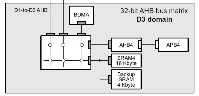

How do I move data continuously over DMA from an array in memory to a 8-bit set of GPIO pins/bus? I feel like this should be simple, but I am majorly stumped. I am using an STM32H7 Nucleo board.

Set up a timer to trigger a periodic DMA transfer. Set up that DMA stream to transfer between an array to GPIOx->BSRR. Only works if all pins are on the same port. Frequency will be limited so something on the order of 10 MHz.

0693W00000HnhZeQAJ.jpgWant a 16-bit write to ODR, or 32-bit to BSRR, would suggest the latter as you can pick the pins you want to leave an those you want to touch.
Seem to recall the GPIO is on AHB4, so perhaps SRAM4 via BDMA
I built an example the other week or two ago, and there was a thread
