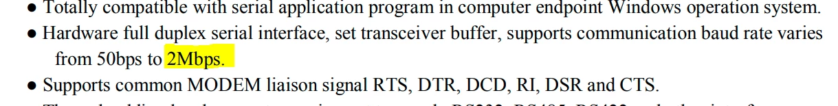

A quick glance suggests the CH340 only works up to 2MBaud per the datasheet. Doesn't explain the issues at 1.5, of course.
0693W00000Hom4EQAR.pnghttps://cdn.sparkfun.com/datasheets/Dev/Arduino/Other/CH340DS1.PDF
