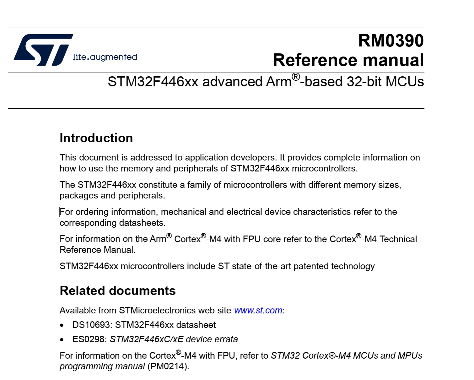

How do I know when to use Reference Manual or Datasheet for a stm32?
How do I decide which documentation to use for a specific problem, or for getting a specific information?

Hi ​@vishnu_illikkal
You should consider these documents as complementary; it ultimately depends on the specific issues you encounter.
Reference Manual:
Understanding of the bus architecture, memory, DMA, and peripherals usage, registers and bit definition.
Datasheet:
Pinout assignment, electrical and physical specifications of peripherals or memories and AMR, as well as package characteristics.
Errata Sheet:
Silicon revision limitations, their description, and possible workarounds.
Here below the introduction of a RM which describes the STM32 documentation usage.
Best regards,
Romain

RomainR.
RomainR.Best answer
Aug 12, 2026 8:04 AM UTC
Reference Manual:
Datasheet:
Errata Sheet:
Best regards,
Romain
