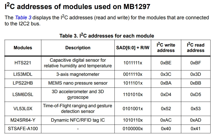

    Is there any further explanation how to communicate with those modules in source code?
    Thank you very much in advance.
    Suryadi

    Suryadiputra Liawatimena
    March 16, 2018
    Posted on March 16, 2018 at 19:00
    access
    https://os.mbed.com/teams/ST/code/DISCO_L475VG_IOT01-Sensors-BSP/docs/tip/
    try to use Mbed with disco_l475vg_iot01 board.
