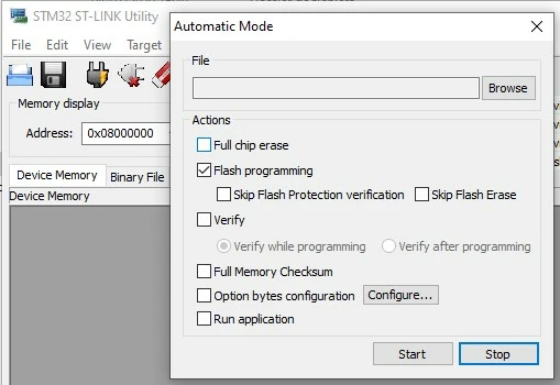

How do I get my flash programmer to reset an STM32G070 after programming it, so that I do not need to cycle power to run the just-download code?

I've tried using IAR and the Segger Flasher to program an STM32G070. However, neither programmer will reset the MCU, so that I do not need to cycle power to run the just-download code? I've seemingly tried every type of Reset. What am I missing?

If you use a ST-LINK, you can try with STM3 ST-Link Utility => Menu Target => Automatic Mode...
You can check "Run application"
