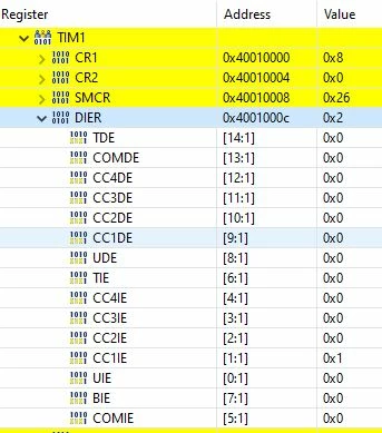

0693W000008zpWMQAY.jpgThe UIE bit for DIER for TImer 1 is set to zero.
waclawek.jan
Apr 16, 2021 11:04 PM UTC
Well, then TIM1_UP_IRQHandler() won't be called.

Just for reference, the work-around is to write directly to the TIM1 DIER register with the bits set to 1 for CC1IE and UIE to turn on both the Capture/Compare Interrupt and the Update Interrupt.
Place this instruction after the Cube IDE generated code so that it overwrites the incorrect Cube IDE settings.
/* USER CODE BEGIN TIM1_Init 2 */
 TIM1->DIER=0x3;
 /* USER CODE END TIM1_Init 2 */

HAL_TIM_Base_Start_IT does indeed set the UIE bit in the DIER register but I need to generate a PWM pulse output with timer 1, so I can't use HAL_TIM_Base_Start_IT.
When I use HAL_TIM_PWM_Start_IT, it should also set the UIE bit to one but it doesn't. I assume this is a bug in CubeMX.
To fix this, I write directly to the DIER register using TIM1->DIER=0x3; right after the HAL_TIM_PWM_Start_IT instruction. That sets the UIE bit to one and the interrupts then work.
