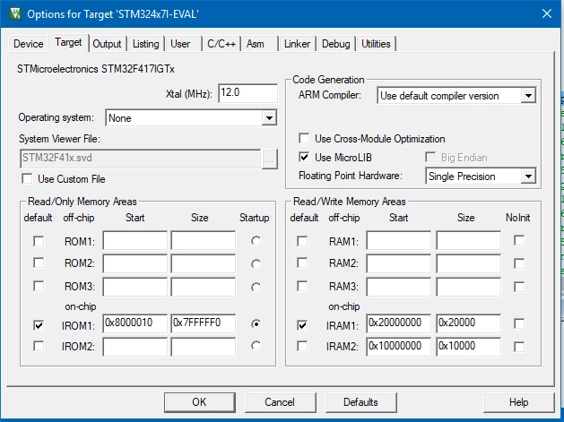

Using STM32F417, programs uploaded to internal flash start executing at address 0x0800_0000.
I want to start the program at 0x0800_0010 instead. The reason for the extra bytes at the beginning of flash is to save status bytes that indicate the state of the startup or bootloader in case of a failure during firmware updates.
By going into flash options in KEIL uVison, I can change the ROM settings to program to flash starting at that address.
If I then go to the LINK Utility, I can see that the program does indeed start at the new address, but it will not execute.
The program is still probably still starting at the beginning of flash.

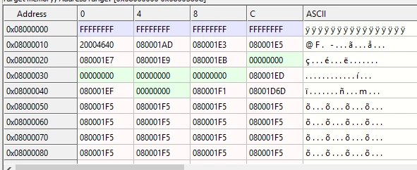

    Gordon Madden
    Jun 24, 2017 12:57 AM UTC
    Posted on June 24, 2017 at 02:57
    Thanks for the answers, I'm trying to follow along.
    So, first I went to the flash options in KEIL uVision and set the IROM to 0x0800_0010, instead of 0x0800_0000 (below)
    In the SystemInit() function in system_stm32f4xx.c file, there is a Vector Table setting for FlashBase
      /* Configure the Vector Table location add offset address ------------------*/
    #ifdef VECT_TAB_SRAM
     SCB->VTOR = SRAM_BASE | VECT_TAB_OFFSET; /* Vector Table Relocation in Internal SRAM*/
    #else
     SCB->VTOR = FLASH_BASE | VECT_TAB_OFFSET; /* Vector Table Relocation in InternalFLASH*/
    #endif
    Then I set the #define for the FlashBase (Peripheral Memory Map in stm32f417xx.h) to 0x0800_0010U, instead of 0x0800_0000U (below)
    #define FLASH_BASE 0x08000010U /*!< FLASH(up to 1 MB) base address in the alias region*/
    I then compiled and loaded the program, but it does not run. Opening the ST-LINK Utility and connecting to the device shows that the program is loaded at 0x0800_0010 (below).
    So, changing the #define for the FlashBase doesn't work and I don't understand exactly why.
    Above, CliveOne mentions that the VTOR could be changed to another address at a 512 offset.
    How would you set the program to start executing at 0x0800_4000 (the next page, 16K later)?
    If you can do that, why not at 0x0800_0010?
    I will look into using SRAM for saving the state as CliveOne suggests.
    Thanks again!
    Tesla DeLorean
    Guru
    Jun 24, 2017 6:03 PM UTC
    Posted on June 24, 2017 at 18:03
    You don't get to define the address, the processor isn't going to start at 0x08000010 or 0x08004000 just because you want it to. The silicon doesn't provide that functionality.
    Put the data some place else.
