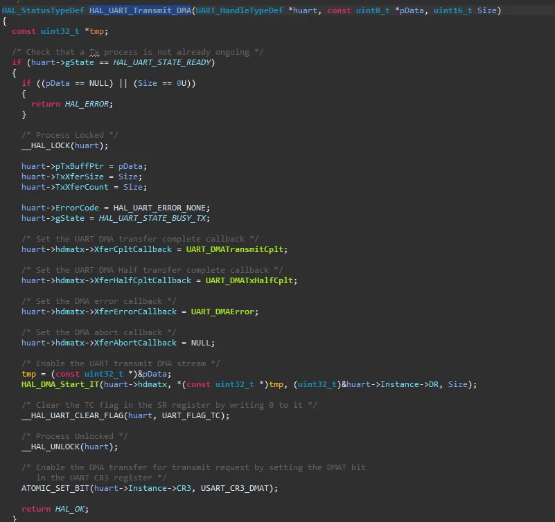

I've checked some codes for example HAL_UART_Transmit_DMA(). I know it is set to sned 8 bit to peripheral. But I wondered when DMA knows that UART sent 8 bit when it is TX DMA or recevied 8 bit when it is in RX DMA. In this case it is TX.
I've checked what HAL_UART_Transmit_DMA() does :
And there was this HAL_DMA_Start_IT(). So it works that DMA sends it's data from memory to UART TX registers. Ok. So tmp is the memory we have the data, and the Instance-> DR is the register the data must be sent.
So where exactly there is info about turning on the UART to transmit data, and when does the DMA know that UART sent 8 bit and is ready to send another 8 bits ?
I've also noticed this :
But I don't understand what it does ? It turn on the UART transmit ?

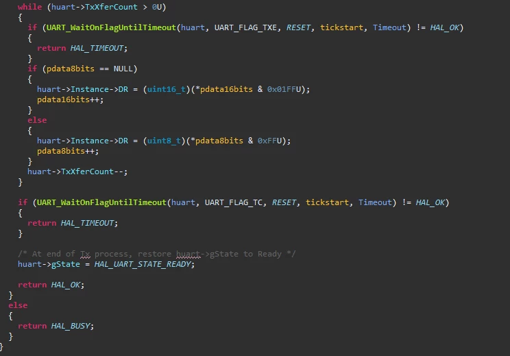

Sorry for being to picky I was quite a bit confused due to the fact that in HAL_UART_Transmit there is a while which has a counter that sends 1 byte
Although I don't know if it has any info back whether it has sent the data or not. It's so confusing ... There is no waiting time or anything.

> HAL_UART_Transmit  ... while doesn't check if the data was sent it just goes on, like it sends data to TX without a break
It does wait, in UART_WaitOnFlagUntilTimeout()
> UART_CR3.DMAT says that DMA transmit data to TX register when UART sends TXE
Basically, yes.
As long as TX buffer is empty and UART transmitter is enabled, TXE is set. TXE is a signal from UART's logic (a wire), and UART_CR3.DMAT is a flip-flop which retains the value you've written to it. Output of that flip-flop and TXE are fed to an AND gate (i.e. any one of those two signals is 0, the AND's output is 0) and the output of AND is fed to DMA's input which triggers the DMA transfer.

>where exactly there is info about turning on the UART to transmit data?
in the initialisation of the uart instant, we can choice to turn on or off both TX and RX. If TX is on, WE Can Do a transfert whenever TXE is set.
>when does the DMA know that UART sent 8 bit and is ready to send another 8 bits?
The DMA know that when TXE is set.
This command enable the DMA mode for transmission.

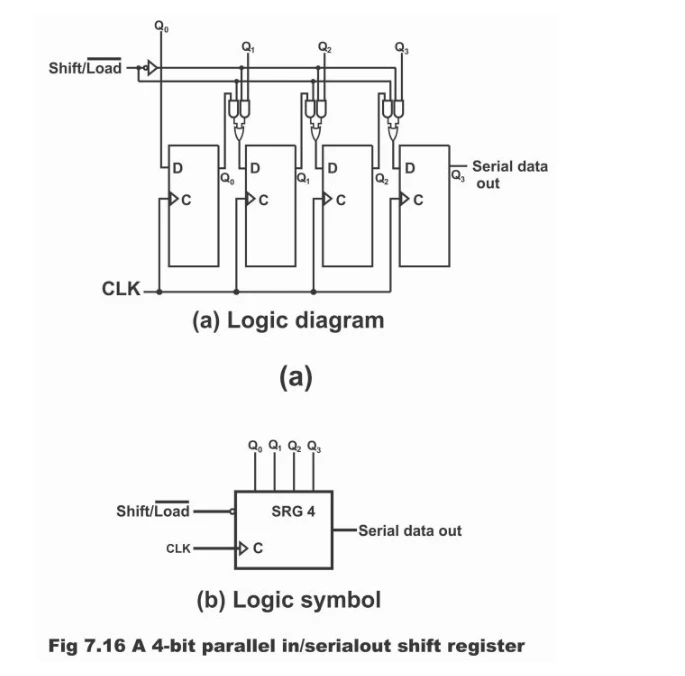

> How does the register or something know that UART is empty to send this TX flag ?
The UART Tx hardware is basically a shift register and a counter (which counts, how many bits remain to be transmitted, i.e. at the beginning it's at 0). TXE is a flip-flop, which after enabling transmitter is set to 1. When you write a byte into the data register, TXE gets cleared. Then UART checks, if the counter is zero, and if it is, the byte gets transferred from the data register into the shift register, together with a startbit and a stopbit, and at the same time the counter is set to 2+8 (or whatever the data length is). Data register is now empty so TXE gets set to 1. If you now write another byte in to the data register, TXE gets cleared and it does not get set to 1 again until the byte is transmitted from the shift register and counter is zero. The baudrate generator clocks out the bits from the shift register and at the same time decrements the counter; as soon as counter gets to zero, baudrate generator thus transmission stops. If there is already a byte in the data register, it gets transferred to the shift register, TXE gets set, and the whole process starts again.
Something like this ?
But this picture is not enough. Because there must be something a logic gate to stop UART from transmiting and stops the clock ? To make sure the data is set in the shift register. Or rather I don't know if I am right but the clock must be disabled in shift register to not send data I think ?
The TX flag is from different register I guess ? And it acts as input or as output, I wonder how.
Don't get me wrong here, I understand the concept you have told me and as I understand UART doesn't check the counter until the TX flag is cleared. When it is cleared it checks the counter and when it's 0, it loads the data from register to shift register and I think it, and then the counter is not 0, I don't know if 8/10 number can be treated as "1" or "0" in the shift/write register. But I think that's how it would work.

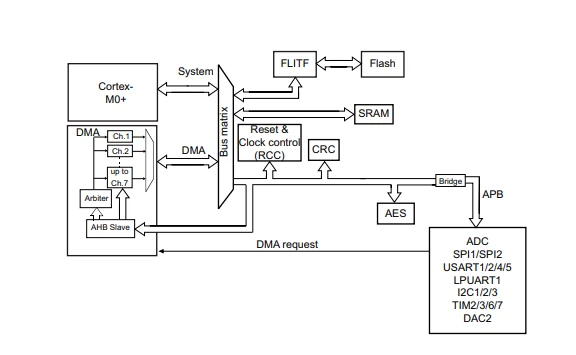

The picture how DMA works doesn't tell a lot :
Like how it works exactly AHB Slave I believe is for configuration like which channel or which devices uses this DMA, and the DMA output bus I guess is to make this transfer, I wonder how it works like it know the address so it goes to that address and takes somehow the value and stores it in a register not shown in the RM ? I guess. How he searches the devices/memory like there is some logic gates for scanning already built in ?

On the picture, note the thin arrow labeled DMA request. This is signal from a peripheral to DMA that tells the DMA to move next piece of data. UART has two these request lines, for RX and TX. Every DMA-capable peripheral has these lines.  All other information (addresses of UART registers, direction of move...) you specify in the DMA channel configuration.
So CPU configurates the DMA for which request he has to wait, addresses ect. the UART only turns on the DMA request transmission.
That's a parallel-loaded shift register (sometimes also denoted as parallel-in-serial-out, or PISO); yes, that's one part of it. The other is the bit counter I've mentioned together with shift register. And of course there's a bunch of auxiliary glue logic to gate clocks, determine counter being at zero, etc.

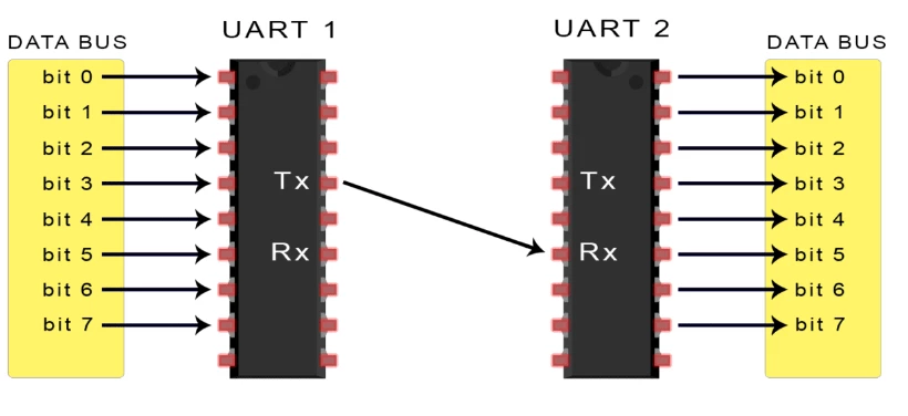

> UART devices pictures shows only data bus and TX RX like here :
Yes. That's the same as when you talk about a building, say the Empire State Building in New York - the vast majority of public information is how it looks like from the outside; only a few people are interested in, and have seen, the blueprints according which it has been built.
That's because again, you are looking at a block schematics of all elevators in the Empire State Building, together with the related electric power grid and the traffic distribution. You want to know how one elevator (here: channel) works, so read the description of channel-related registers at the end of the DMA chapter, and then read the functional description. It takes several re-reads, and I recommend you to try to draw yourself block schematics and charts, according to what you are reading.

I thought that when everybody know how UART is working from logic gates then I thought it might be helpful in understanding stuffs or how to write charts etc. So I wanted to know where I can start.
