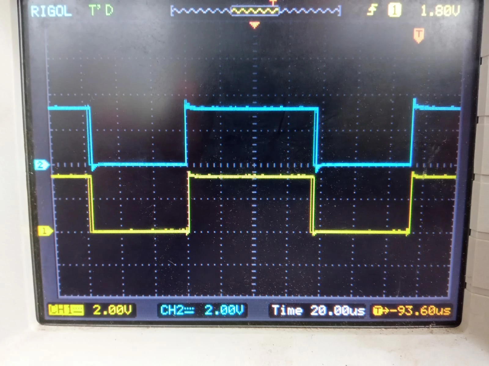

I have set Timer 8 to PWM Generation CH2 CH2N. Based on the value read by the ADC, I want to change the polarity of both CH2 and CH2N. I have found that using
__HAL_TIM_SET_CAPTUREPOLARITY
, I could change the polarity of CH20693W00000NqkcWQAR.jpg but the polarity of CH1N remains the same as shown in the image. So how could I change the polarity of both CH2 CH2N ?

KnarfB
May 27, 2022
__HAL_TIM_SET_CAPTUREPOLARITY is for input capture, but not for output compare which does the PWM output here. You may switch from PWM mode 1 to PWM mode 2.

waclawek.jan
May 27, 2022
It's the same bit, TIMx_CCER.CCxP, even if maybe Cube/HAL has different incantations for it.
The CCxN channel's polarity is similarly controlled by TIMx_CCER.CCxNP. You can try to find some Cube/HAL macro for that if you want, Cube is open source.
Output Compare mode is determined by TIMx_CCMRx.OCxM field, simply change that field for different mode.
Read the TIM chapter in RM.

waclawek.jan
May 29, 2022
TIM8->CCER |= TIM_CCER_CC2NE [EDIT] see post below [/EDIT]

ForgottenTale
May 29, 2022
This doesn't seem to work. The PWM isn't getting inverted
waclawek.jan
May 29, 2022
Ufff.... sorry.... CCxNE is the Enable bit for the TIMx_CHxN channel. Polarity is swapped using the CCxNP bit:
TIM8->CCER |= TIM_CCER_CC2NP;
ForgottenTale
May 29, 2022
PWM channel of CH2N got inverted, but it didn't work for CH2. Also, I need toggle between non-inverted and inverted PWM based on the value read from the ADC. How can i do that ?

waclawek.jan
May 29, 2022
As I said like 3 posts ago, it's CCxP for the TIMx_CHx and CCxNP for TIMx_CHxN.
TIM8->CCER |= TIM_CCER_CC2P;
Have you read the TIM chapter in RM? And within it, the CCER register description?
Have you experimented with the TIM registers in the debugger?
