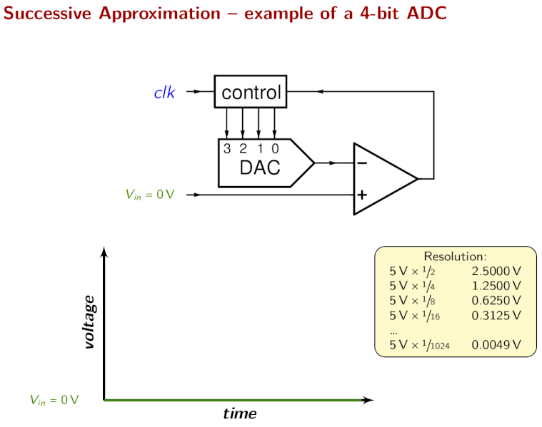

I have only a rudimentary understanding of how SAR ADCs work, but if I understand you and them correctly - you are assuming that the approximation value should approach the sampled voltage monotonically - and that assumption is not valid.
The WP article on SAR ADCs suggests the helpful mental model of the SAR process as binary search.
In line with that, what you should see at every step is only that the absolute value of the error, between the approximation and the sampled value monotonically decreases (or to be pedantic, non-increases) with each step.
And in fact, in your example, it does:
Cycle timeApprox mV.|622mv-approx|
1.5135487
2.5150472
8.5234388
16.5341281
32.555765
64.563816
387.56220
810.56220
As another example, this animation from WP  shows that, depending on the sampled value, there can be some "overshoot" during some intermediate step(s), just like in your example.
https://en.wikipedia.org/wiki/File:4-bit_Successive_Approximation_DAC.gif
759px-4-bit_Successive_Approximation_DAC

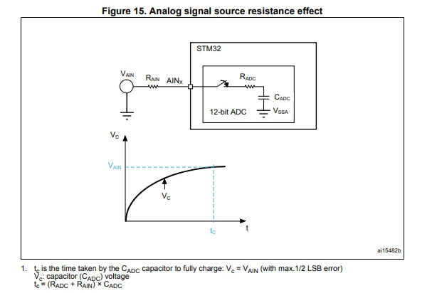

maybe, i can give you some idea ...
1. your experiment is out of "defined working area" , as @STOne-32  explained .
2. The ADC is a charge redistribution SAR ADC , read a little, how this works, if you want:
https://www.renesas.com/us/en/document/apn/r14an0001-operation-sar-adc-based-charge-redistribution-rev100?language=en
or from STM
https://www.st.com/resource/en/application_note/an2834-how-to-optimize-the-adc-accuracy-in-the-stm32-mcus-stmicroelectronics.pdf
3. Such ADC has an input sample-hold cap, maybe 5pF , that has to be charged to the input voltage it should get.
So needs some minimum time, depending on the source impedance also.
Now you know, why its working fine, if you keep to this (calculated) values for sampling time vs. source impedance.
4. But there is a small "black hole" in this story - nobody talks about:
after the SAR conversion, switching its internal caps...until sequence finished, the "input sampling cap" still has some charge, depending on the sequence/hardware inside the ADC structure.
THIS charge will come OUT of the ADC, when the next ADC sequence starts with switching the cap to the input pin.
And so you get a small current coming out from the ADC input, that depends at first on the speed of conversions, the basic internal structure of the ADC and (maybe) on the last voltage level, the sampling cap was charged on the previous conversion.
This "current" can easily be measured and might in some "border cases" give strange phenomena - as here, when you see a "magic" voltage increase at some certain high-impedance input and certain sampling time and speed.
So you know now...why this can happen. :)
