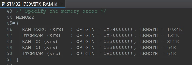

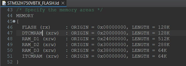

How can sram sizes be different in ram and flash linker files?
RAM_EXEC section 1024K but RAM_D1 is 512K. How is this possible?

Likely simple oversight, perhaps edited from an H7 linker script with 1MB FLASH, or misreading the data sheet title page

Hi @OguzhanBalci,
Thank you for reporting this issue.
I highlighted this topic via an internal ticket number 181750 for fix.
(PS: Internal ticket number 181750 is only for reference, not available outside of ST).
Thank you for your contribution.
