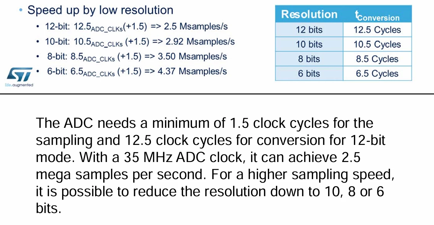

Hello
I am using STM32G030 but my question is not specific to G series
How can I view the number of ADC conversions per second?
For example I can put Counter++ in (DMA circular )HAL_ADC_ConvCpltCallback  And get it in seconds using a timer?
The G030 has a 12-bit ADC with 2Ms/s
ADC clock of 32 MHz divided by 2 = 16 MHz (12.5 + 1.5) should be 1.1Msample/s? is not it?
Is this practical?

Your question is not practical. ADC have docu and on init you define speed of conversion .
Some years ago i here ask why MX not shown this values , when ADC is configured. I mean still not show, then you need calc this. For example
STM32G0-Analog-ADC-ADC.pdf

I am testing it right now
When I put ADC_SAMPLETIME_160CYCLES_5, the counter shows the number 92486. But when I set it to ADC_SAMPLETIME_79CYCLES_5, it stops working
