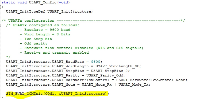

Hi.
Now I'm trying to understand the alternate function mapping with simple example of  'STM32F4xx_StdPeriph_Examples\USART\USART_HyperTerminal'
But there is nowhere the setting of alternate function mapping to use PA9 as USART1_TX (AF7)
I think it should be in there about the setting of alternate function mapping
Could you please let me know how can I understand this?
Even I can find the same function USART1_TX and USART1_TX PA9 PA10 and PB6 and PB7.
So If I want to use PB6 to USART1_TX not PA9 then what am I supposed to ?
Could you please with any example snippet code?

    in the main.c file the STM_EVAL_COMInit function Configures the COM port

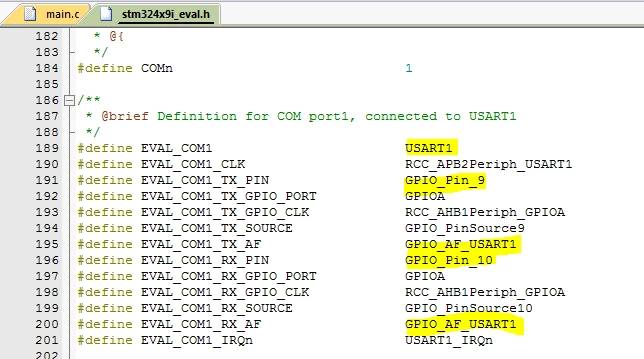

    in thestm324x9i_eval.h for example you find the definitions of theCOM port0690X00000608BuQAI.png
    you can use thiefunction below to Change the mapping of the specified pin
     /* GPIO Alternate functions configuration function ****************************/void GPIO_PinAFConfig(GPIO_TypeDef* GPIOx, uint16_t GPIO_PinSource, uint8_t GPIO_AF);�?�?

      * @brief  Configures COM port.
      * @param  COM: Specifies the COM port to be configured.
      *   This parameter can be one of following parameters:
      *     @arg COM1
      *     @arg COM2
      * @param  USART_InitStruct: pointer to a USART_InitTypeDef structure that
      *   contains the configuration information for the specified USART peripheral.
      * @retval None
    void STM_EVAL_COMInit(COM_TypeDef COM, USART_InitTypeDef* USART_InitStruct)
      GPIO_InitTypeDef GPIO_InitStructure;
      /* Enable GPIO clock */
      RCC_AHB1PeriphClockCmd(COM_TX_PORT_CLK[COM] | COM_RX_PORT_CLK[COM], ENABLE);
      if (COM == COM1)
        /* Enable UART clock */
        RCC_APB2PeriphClockCmd(COM_USART_CLK[COM], ENABLE);
      /* Connect PXx to USARTx_Tx*/
      GPIO_PinAFConfig(COM_TX_PORT[COM], COM_TX_PIN_SOURCE[COM], COM_TX_AF[COM]);
      /* Connect PXx to USARTx_Rx*/
      GPIO_PinAFConfig(COM_RX_PORT[COM], COM_RX_PIN_SOURCE[COM], COM_RX_AF[COM]);
      /* Configure USART Tx as alternate function  */
      GPIO_InitStructure.GPIO_OType = GPIO_OType_PP;
      GPIO_InitStructure.GPIO_PuPd = GPIO_PuPd_UP;
      GPIO_InitStructure.GPIO_Mode = GPIO_Mode_AF;
      GPIO_InitStructure.GPIO_Pin = COM_TX_PIN[COM];
      GPIO_InitStructure.GPIO_Speed = GPIO_Speed_50MHz;
      GPIO_Init(COM_TX_PORT[COM], &GPIO_InitStructure);
      /* Configure USART Rx as alternate function  */
      GPIO_InitStructure.GPIO_Pin = COM_RX_PIN[COM];
      GPIO_Init(COM_RX_PORT[COM], &GPIO_InitStructure);
      /* USART configuration */
      USART_Init(COM_USART[COM], USART_InitStruct);
      /* Enable USART */
      USART_Cmd(COM_USART[COM], ENABLE);
