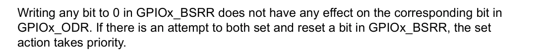

JR2963
Senior II
January 31, 2024
What has priority?
What if I set in one step GPIOB->BSRR =(1<<0) | (1<<16); ?

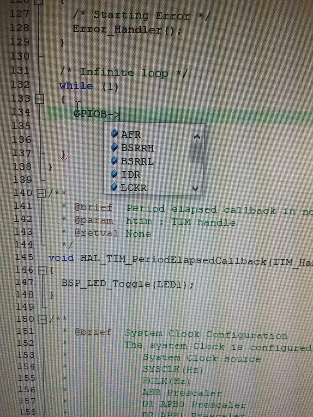

@Community member​ GPIOB->BSRR =(1<<0); it worked that way, but The use of bsrr register looks like in the picture.There is not error in the program ,but it looks that way.0690X000009YvCXQA0.jpg0690X000009YvBtQAK.jpg

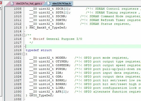

@Imen DAHMEN​ first image is generated codes in the stm32cubemx 5.2.1 version ,other older version 0690X000009YvMNQA0.jpg0690X000009YvMrQAK.jpg

Hello @Bilge​ ,
Which Cube firmware package are you using ?
In fact, in the last firmware package CubeH7 v1.4, we have replaced BSRRL and BSRRH registers (In device header file (ex. stm32h743xx.h) and in GPIO type def) by one 32 bit register BSRR as defined in Reference manual.
Best Regards,
Imen
Bilge
BilgeAuthor
July 19, 2019
Thank you for your reply @Imen DAHMEN​ STM32CubeH7 Firmware Package V1.4.0 / 05-April-2019

JR2963
Senior II
January 31, 2024
no it is not. I found only this but probably it is not answer for what I am asking for:
gbm
January 31, 2024
Well, that's exactly the answer you were looking for. Just read the last sentence.
It would be clearer if "in" was replaced by "via". (Just a hint to ST docs editors. ;) )
My STM32 stuff on github - compact USB device stack and more: https://github.com/gbm-ii/gbmUSBdevice
JR2963
Senior II
January 31, 2024
OK if there would be via, then it is answer for me
