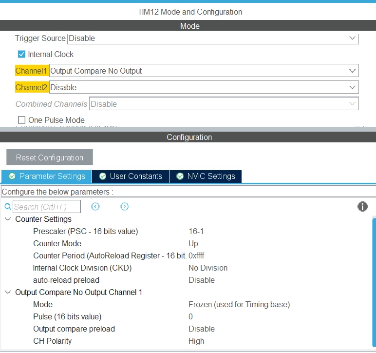

How can I use Capture Compare as external trigger source?
Hi!
This might be a simple question, but I still haven't solved it.

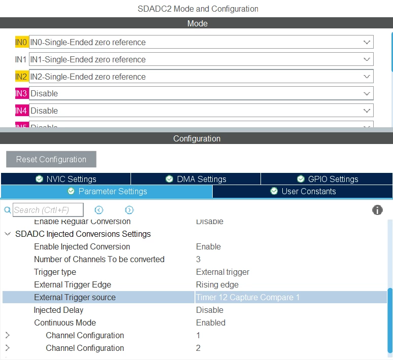

I want to create an external trigger source for SDADC 16-bit and I have selected TIM12 Capture Compare 1 as external trigger source.
Then I have enable the Output Compare, because I did not find Capture Compare.
Then I enable the NVIC for the SDADC.
	HAL_TIM_Base_Start(htim13); /* TIM13 is trigger source for SDADC1 */
	HAL_TIM_Base_Start(htim12); /* TIM12 is trigger source for SDADC2 */
	HAL_TIM_Base_Start(htim16); /* TIM16 is trigger source for SDADC3 */
	if (HAL_SDADC_InjectedStart_IT(hsdadc1) != HAL_OK)
		Error_Handler();
	if (HAL_SDADC_InjectedStart_IT(hsdadc2) != HAL_OK)
		Error_Handler();
	if (HAL_SDADC_InjectedStart_IT(hsdadc3) != HAL_OK) /* Differential only */
		Error_Handler();
But still. Nothing happens when I have this function avaiable.
This never calls. Why?

Include your chip part number.
You start the timer, but I don't see you starting the channel anywhere. Should be a call to HAL_TIM_OC_Start or similar.

Did not work to use HAL_TIM_OC_Start(htim, TIM_CHANNEL_x)
STM32MP151AAC3 custom board with STM32-OS as operating system: https://github.com/DanielMartensson/STM32-ComputerSTM32MP257FAK3 custom board with STM64-OS as operating system: https://github.com/DanielMartensson/STM64-Computer

If you want to trigger the SDADC using a signal coming from outside the STM32, you have to set the timer's channel to Input Capture.
Read the timer chapter in RM.

So if I want a trigger source that using a signal inside the STM32. How should I do then?
