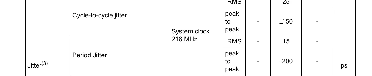

Just use a precision clock (Sixxxx, whatever) as master clock for the cpu (HSE -> bypass setting in Cube),
then all timing is coming from this clock.
But with the "standard" crystal on your board, you already have about 10 exp -5 "precision" clock.
And down to ps precision you cannot go with a cpu and PLL inside, see ds for jitter levels.
...no matter, what clock you use for the cpu.

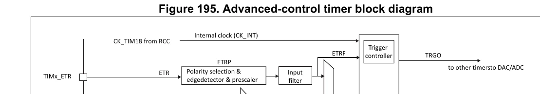

Other way: let cpu run on its clock as it is, but use external clock input only for the timer, then it might be close to few ps jitter. (if your extra oscillator is good enough...)
btw
Si5351
->  100ps pp low output period jitter .

Do you want to use this external Clock Generator as the clock source for the entire processor, or just for the timers doing the PWM ?
March 14, 2025
Just the timers for the PWM
