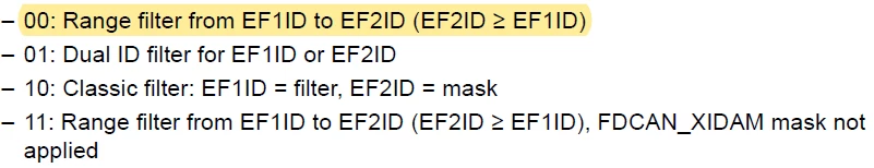

Hi everyone,
I am working on a FD-CAN project and i am able to send a 64 byte data frame. But I want to send multiple frames of data with different IDs. Any help would be greatly appreciated!

You're using the filter in Mask Mode and that's normal. Try to use FDCAN_FILTER_RANGE instead of FDCAN_FILTER_MASK.
