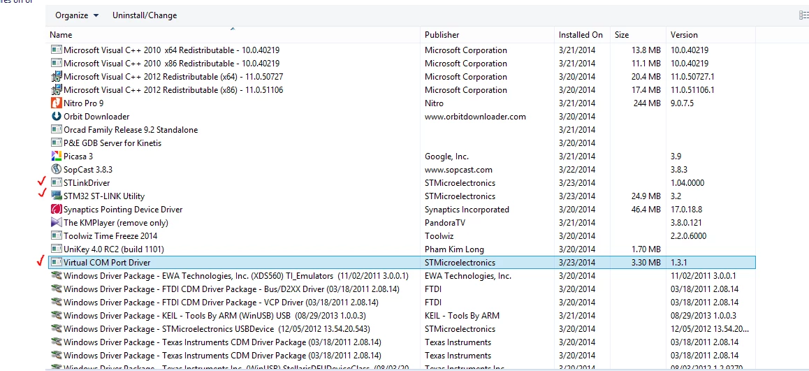

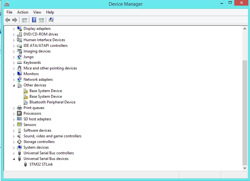

Hi everyone,
 I am a newbie with the KIT STM32F4 Discovery. So, now I want to use USART to send and receive data through Virtual Com Port (using Micro USB) but I have some problems with this. I can't find any COM in Device Manager in the PC. I 've read many threads about this problem but now, It's only a mess in my mind. So, someone please tells me Steps to run the USART project. one more question,  are there any libraries for this ? My English is bad , so please forgive me if I say anything wrong. Thank you very much. 0690X00000605XxQAI.png0690X00000605Y2QAI.png

Hi
'' I am a newbie with the KIT STM32F4 Discovery. So, now I want to use USART to send and receive data through Virtual Com Port''
You cannot!
The USART is a physical RS232 port. It must connect to another UART of some kind.
(The USART only works to Vdd 3.3V - you MUST use a RS232 level converter such as a MAX232 to connect with another RS232 port)
You can get USB to RS232 cables which will plug into your PC.
Then, you can connect the STM32 USART to PC via this converter.
OR
VCP - is RS232 emulated through USB. This requires the STM32 to implement a USB device - the CDC device from the USB OTG library.
You can then connect the USB of the STM32 directly to the USB on your PC and it will appear as a VCP device.
