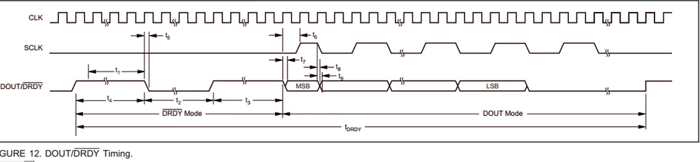

I'm trying to read an external ADC output.
The data are provided thru a DRDY pin.
When the DRDY falls, it generates an interruption in my STM32L1 (falling edge). Then, I must read the DRDY level eevery rising edge of a clock provide by the STM32L1 to the ADC.
Sould I configure the EXTI pin (PA3) in the callback function as input mode everytime the interrumption happens? (and then, before exiting to re-configure as EXTI)

    As long as an GPIO is not in analog mode, IDR always reflects to logic level at the pin. So no need to redefine.

    Thanks Uwe. It's OK. The problem was in the protocol towards the external ADC

    I'd like to know the how the external ADC works? it's an IC? what's its name?

    It's an external Sigma-Delta 24 bits ADC

    2-wire serial interface? like this?
    Should I configure the EXTI pin (PA3) in the callback function as input mode everytime the interruption happens? (and then, before exiting to re-configure as EXTI)
    You can try that, I think it will work.

    Finally, it is not needed to reconfigure PA3
    But I think that everytime DRDY falls during DOUT Mode, the interruption begins again.
    Should I disable the interruption during DOUT Mode?
