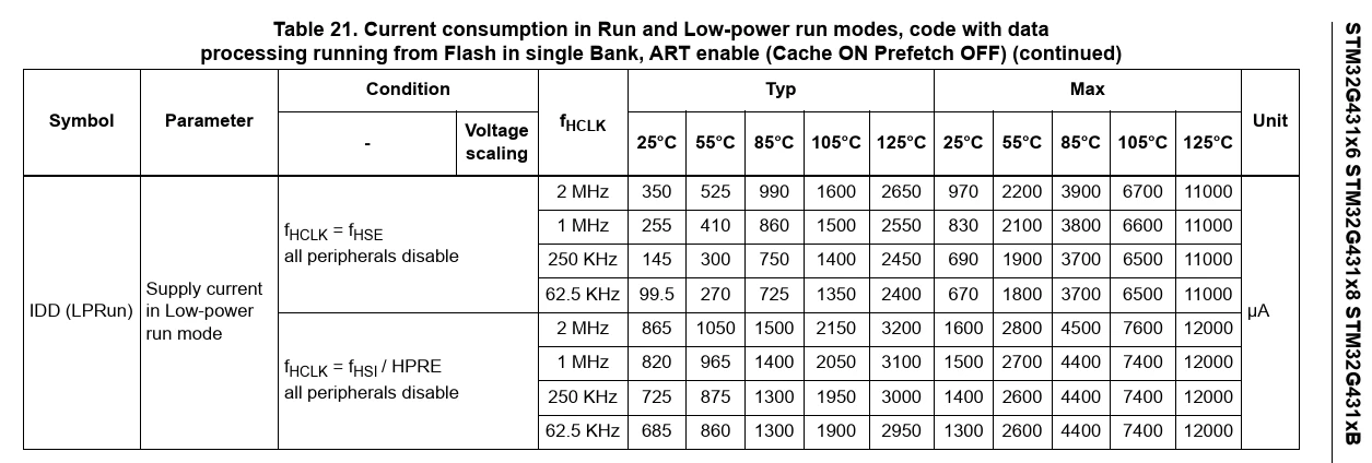

I've been working on reducing the power consumption of a project I'm working on using the STM32G431.
Stop modes are not an option on this chip since I need to keep some peripherals active, but I've been
able to reduce the needed system clock to below 1Mhz, and use the LP-Run/Sleep modes exclusively.
I've gone as far as I can in terms of reducing overall frequency. According to the CubeMx power estimator pane, I can  reduce the power consumption further by about 75% by avoiding the use of a crystal and supplying an external clock
signal instead. This so-called "HSE Bypass" mode powers down the oscillator circuit as well as the PLL.
But I've run into a wall in implementing this. If I can't use a crystal, what do I put on the board to generate my (say, 1Mhz) clock? I don't have an FPGA or a big-brother CPU on the board to provide the clock. And to add one would negate the power savings several times over (to say nothing of the BOM cost).
I've searched for dedicated clock generators, but what I've found so far seems to aim at much higher frequencies and still requires 10x the power used by the G431 to run.
Are there any jellybean chips/solutions for this? basically, I need an IC that generates a (say) 1Mhz clock while consuming only 10-100uA.

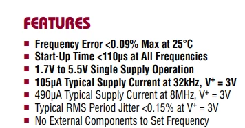

Best answer by AScha.3
So why not just try with HSE crystal, 4MHz , and check real world value then ?
Or with hse-bypass, maybe the lowest possible consumption (if no crystal precision needed) :
584-C6930IMS88.00TPF (mouser)
So you can expect about 150uA at 1MHz setting for this kind of micro-power-osc.

Actually, when you scale HCLK way down, the power consumption gap between LPRUN  and LPSLEEP
is only about 20uA (out of say 160us).
Do those peripherals really need to be constantly active?
I need the DMA to feed the DAC every 20us. that's on the order of the wakeup times for STOP modes, so that doesn't seem worth persuing. With a newer sexier chip like the u5 (and LPDMA), I possibly could employ deeper LP modes, but for now I'm focused on getting as far as I can with the G431.

> According to the power estimator, HSI16 does not provide anywhere near the same power reduction as HSE bypass.
HSE with 8MHz crystal consumes around 500uA typ, according to the DS, while HSI16 around 155uA typ 190uA max. You want to divide the AHB accordingly to run the rest of the mcu at the same frequency (say 2MHz), in order to get them into the same consumption level.
HSE bypass does not consume anything, but the external oscillator does, and it will be in the 150uA ballpark.

There's also interesting but generally unusable (expensive, non-crystal-precision) LTC6906.

1. The power consumption associated with HSI is not 190us, because associated circuitry needed for using it raises that figure considerably.
2. The datasheet does provide information about the power consumption when using external crystals, but in a separate table, not as part of the run mode current consumption tables.
3. the Power Consumption Calculator tool in CubeIDE is an extended version of the datasheet tables
4. HSE. Bypass (i.e external clock) does provides the lowest power consumption overall in Low-Power modes, assuming the external clock source doesn't use up much power (and others have identified suitable solutions for achieving this in this thread).
