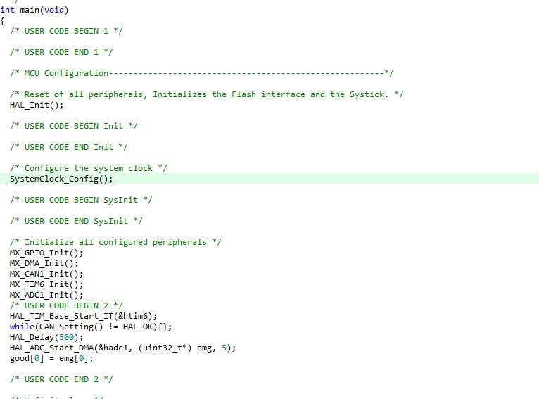

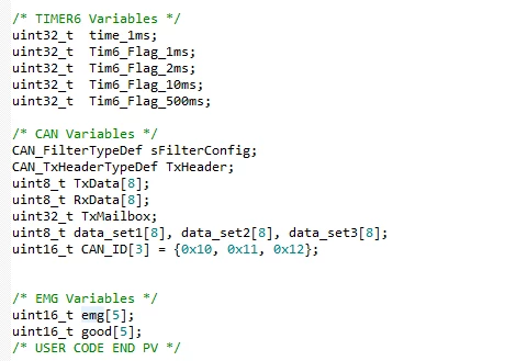

I am using 5 adc values (emg[5]) and can get the value of them.
I want to use these values in the main statement, so I assigned it.
However I can't get the value. It's always zero.  (good[0] = emg[0])
Can I know what's the matter of this,,? Thanks for help!

Hello @lee_daeun and welcome to the community,
First, as stated by @Andrew Neil , you need to copy paste your code using the button </> instead of posting the screenshots.
Second, as stated by @waclawek.jan ,
The DMA transfer is not starting immediately after calling HAL_ADC_Start_DMA():
HAL_ADC_Start_DMA(&hadc1, (uint32_t*) emg, 5);
good[0] = emg[0];
So you need to use interrupt callback HAL_ADC_ConvCpltCallback() and read emg ADC buffer there.

HAL_ADC_Start_DMA() is asynchronous, it means, that it starts the hardware process with ADC and DMA and returns immediately, not waiting for the result. It takes time until the hardware - ADC and DMA - performs the conversions, so you can't read out the results immediately after that function was called.
DMA signals when it's finished by the Transfer Complete interrupt, the is a callback in Cube/HAL which is called at that point and may be a good point to read the results. I don't use Cube/HAL, refer to is documentation or to the examples.

@mƎALLEm wrote:
The DMA transfer is not starting immediately after calling HAL_ADC_Start_DMA():.
It should be starting, but it won't have finished - therefore the results are not yet available.
