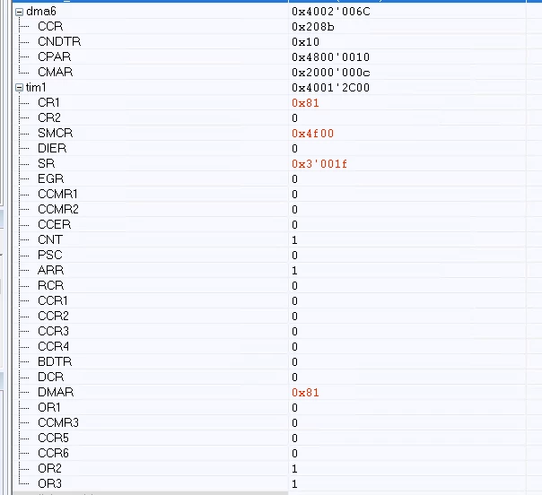

waclawek.jan
April 18, 2022
Read out and check/post content of TIM and DMA registers.
April 18, 2022
Hello @Community member​,
Thank you for replying.
Is this enough?
   ifcr = DMA1->IFCR;
   isr = DMA1->ISR;
   sr  = TIM1->SR;
   dier = TIM1->DIER;
   egr = TIM1->EGR;
I wasn't sure where to set the breakpoint, so I generated a few rising edges on EFR then stopped in the while loop where these were assigned.
All are 0 except SR which is 0x3'001f, and all the lower (set) bits seem to indicate an update is in progress? Not sure how to interpret.
waclawek.jan
April 18, 2022
> Is this enough?
Debugger surely allows you to read out all the registers (all registers of of TIM, common and the channel-specific registers of DMA) comfortably. Post them all.
After a couple of rising edges is OK, as long as it won't run DMA to completion. Otherwise, stop just after enabling everything, before any external signal.
> All are 0
If TIM1->DIER is 0, you don't have enabled DMA trigger nor interrupt. Or you have run to completion and Cube has cleared them for you.
April 18, 2022
@Community member​
Thanks for the insight.
Ok, here are all of them (image below).
However, I think I fixed it. I set the DIER bit for UDE:
   TIM1->DIER |= TIM_DIER_UDE;
I thought CubeMX setting to TIM1_UP would set this bit, but apparently it did not. When I set this bit before while(1){} I now see the data from D0-D7 loading into the memory space (via debugger) and the DMA interrupt being set after 0x10 transfers. Awesome!!! However, the TIM1 requires 32 rising edges, rather than 16, and changing the period does fix that, nor does enabling the DIER_TDE bit since I figured the trigger would work.
Thanks for solving my first part! Any advice on the second part?
