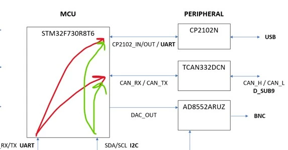

Hi, I’m new to STM32.
With STM32F730R8T6 MCU;
I want to see the data using CAN protocol and UART protocol while sending data using UART protocol.
At the same time, I want to see the data using CAN protocol and UART protocol while sending data using I2C protocol.
I need a sample study on this subject or a topic I can follow or any suggestions.
I don't want ready information, I don't want to be misunderstood.
If there is any resource that can help, I want to examine it.
I tried to visually explain the work I wanted to do with a photograph.
Thank you very much in advance.

I use two sensors. The first sensor gives UART output. The second sensor gives I2C output. I want to transmit these two outputs to the computer via USB.
At the same time, I want to transmit the data from the sensors via CAN.
Yes, there are many instructional videos on Youtube, but I couldn't find a video that takes input with UART and gives output with CAN. So I couldn't find a video that explains both together.
I have watched and understood videos about communication protocols communicating within themselves, but what I want to do is different, isn't it?

Is the data in a form you can forward or tunnel it over the alternate interface.
Are bandwidths sufficient to achieve this?
CAN uses small packets.
Otherwise you need to decide how to process the input data forms, and how you can represent them in a combined form suitable for the interface you are using, and what the end use of this data is.​
