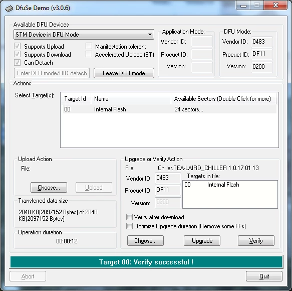

I was able to use elf2dfuse to create a DFU file. DfuSe downloaded the file and verified. However when I reboot my board, the firmware was not updated.0693W00000Y9AHQQA3.pngI have attached the ELF and DFU files. Also, I included the STM32Cube project et al that I loaded to handle DFU transfer. It enumerates, but not sure if it's actually programming the flash.
JDrei.1
JDrei.1Author
January 25, 2023

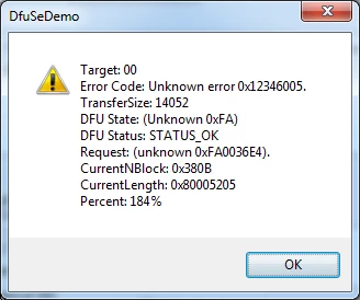

Operator error on DfuSe Demo verify, so ignore the above picture. Now I get:0693W00000Y9AQdQAN.pngI'm guessing the firmware I have loaded in my board will enumerate as a DFU device, but does not actually program the flash.
Tesla DeLorean
Guru
January 25, 2023
The .ELF look built differently from the project
Assuming you have a loader of some sort, as the primary .ELF starts at 0x0800C000 address, and not 0x08000000
Attached are a couple of .DFU
JDrei.1
JDrei.1Author
January 25, 2023
The ELF from the project includes DFU. I use ST-LINK to download it. The other DFU is my project built with WICED. I'll eventually port the STM32Cube source into my project...if I can get it working.
When I try test1.dfu...0693W00000Y9AgzQAF.pngWhen I try test2.dfu...
0693W00000Y9AhEQAV.pngAfter power cycle, the original STM32 app is still running.
