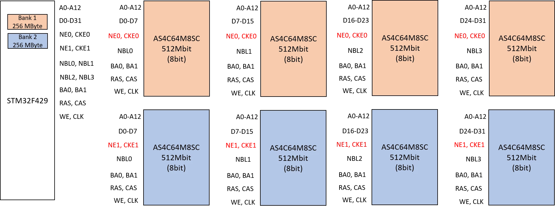

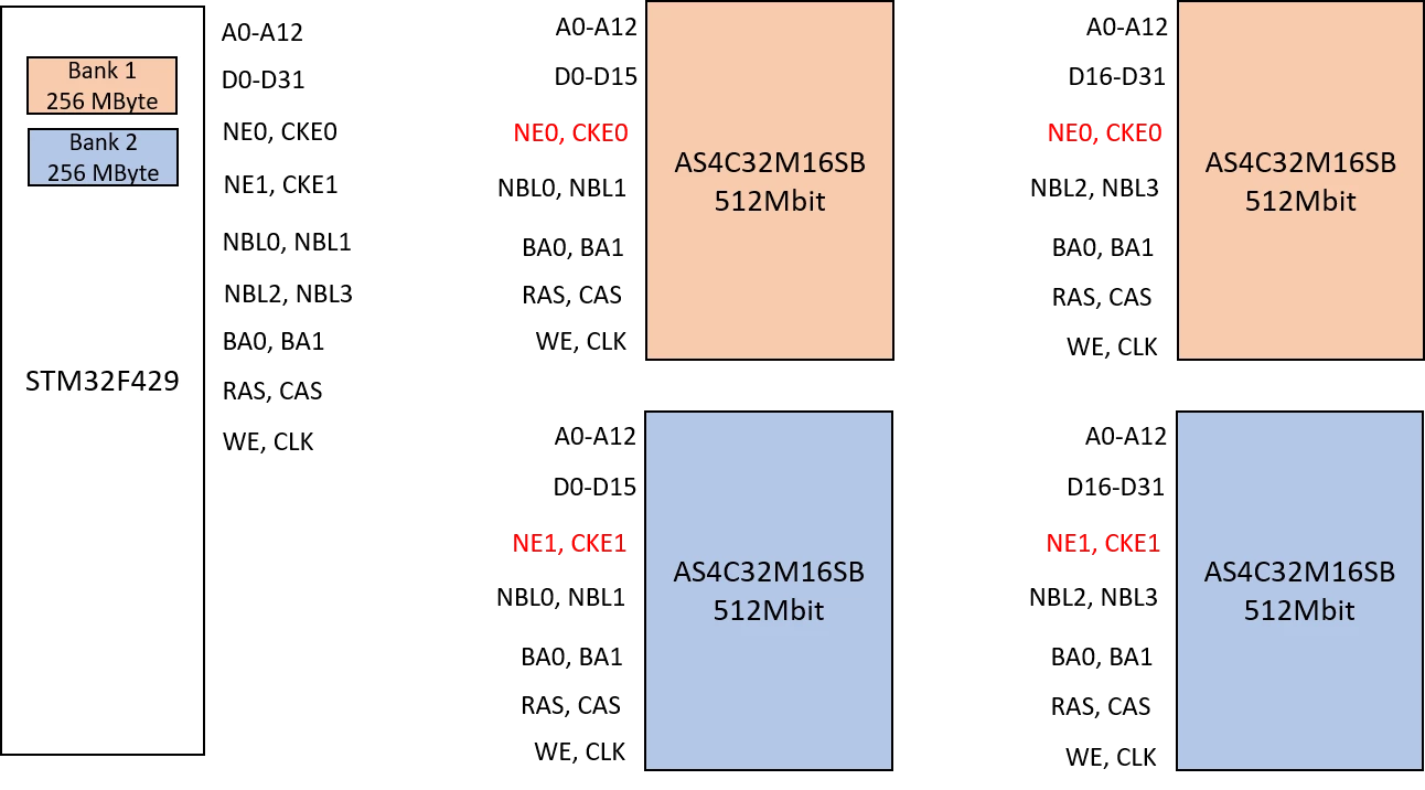

I would like to connect Gbit SDRAM to STM32F429 MCU. When I look at the STM32 FMC memory map, it has two 256 Mbytes area for SDRAM. As far as I understand, I can connect up to 4 Gbit SDRAM. However, SDRAMs have maximum 512 Mbit size.
1) Is it possible to connect multiple (2 or 4) 512 Mbit SDRAM (AS4C32M16SB) to the MCU?
2) If yes, how can I connect multiple SDRAM?
