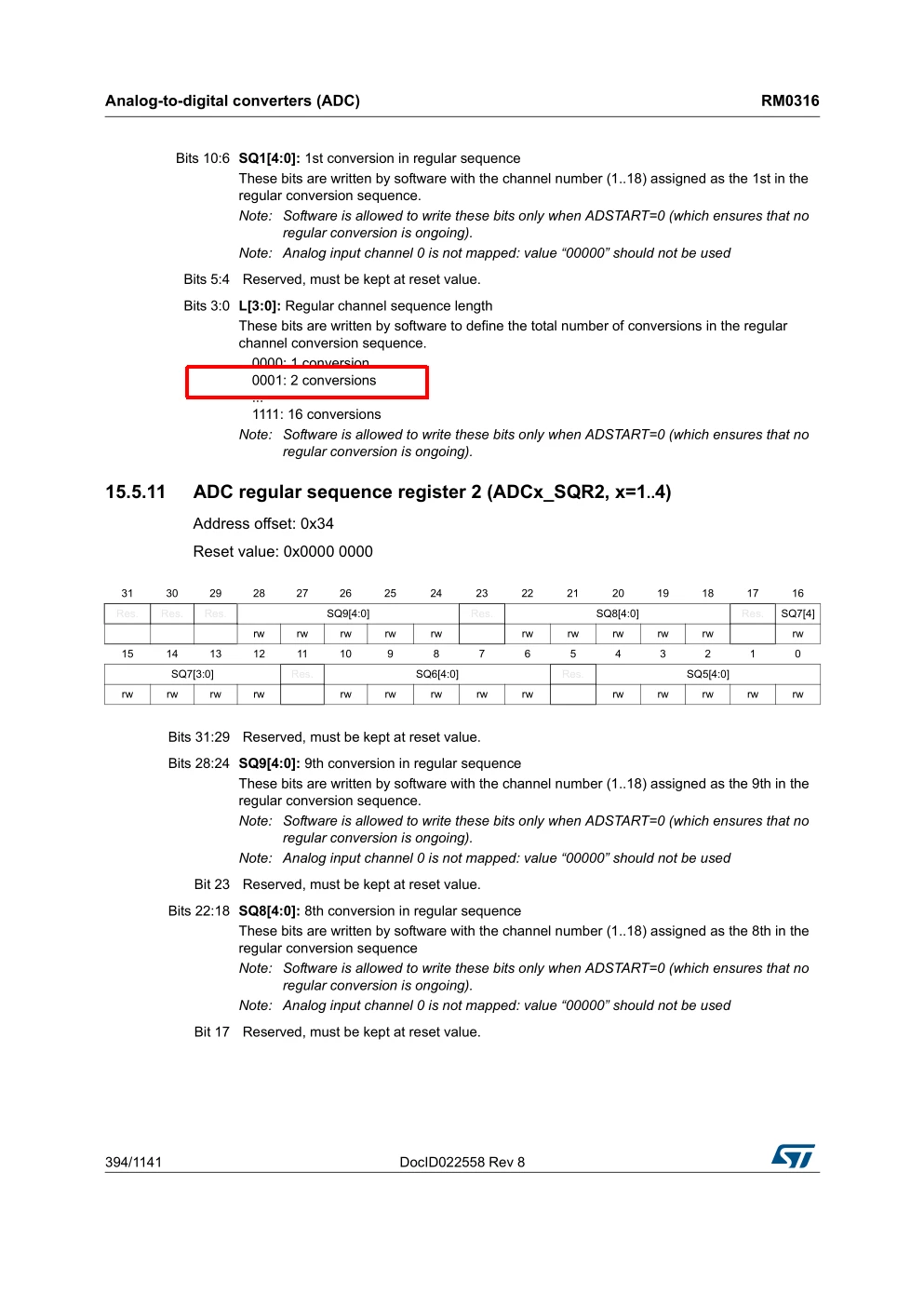

Using DMA results in adc_reading jumping around 0xFFF - as if my analog input voltage was at the analog supply voltage or saturating. Using the ADC interrupt results in adc_reading holding the proper converted value, for example 0x800 at half analog supply voltage.

> Now, adc_readings[0] contains the correct reading on every DMA transfer,
> and adc_readings[1] contains the same garbage value as before.
Now it makes sense!

I am using the STM32F303K8T6 on a Nucleo board (reference board MB1180.) According to the schematic, VDDA is connected to VDD at 3.3V from the on-board regulator and VSSA is connected to ground. The lines look stable as far as I can tell.
Reading out the data register in the DMA ISR gives the same value as stored in adc_reading.
Symmetrical PSIZE and MSIZE did not seem to have an effect, but I did get some progress by changing adc_reading to a buffer of size 2:
static volatile uint32_t adc_readings[2] = {};
With DMA updated to auto increment MEM and read 2 words:
 ADC_DMA_CH->CCR |= (DMA_MSIZE << DMA_CCR_MSIZE_Pos)
 | (DMA_PSIZE << DMA_CCR_PSIZE_Pos)
 | DMA_CCR_CIRC_Msk
 | DMA_CCR_TCIE_Msk
 | DMA_CCR_MINC_Msk;
 ADC_DMA_CH->CPAR = (uint32_t)&(ADC->DR);
 ADC_DMA_CH->CMAR = (uint32_t)adc_readings;
 ADC_DMA_CH->CNDTR = 2;
Now, adc_readings[0] contains the correct reading on every DMA transfer, and adc_readings[1] contains the same garbage value as before. I'm afraid I don't understand why this is occurring, and while it works, I wouldn't consider it a solution. Any ideas on what else I can try? I will try to run the same setup on a different board to see if it is some obscure hardware issue.
Now it makes sense!
bsakas
bsakasAuthor
May 8, 2023
Thank you very much! I figured it would be a detail I overlooked. Works flawlessly now.
