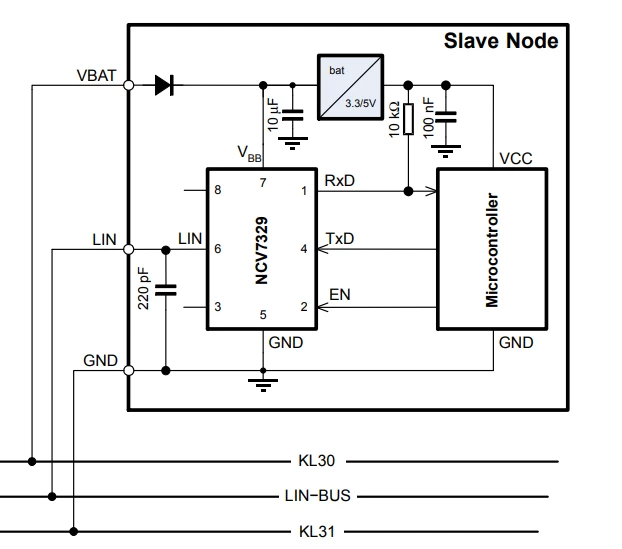

I have a sensor which send LIN message to vehicle, I want to read value of current, voltage, etc, form this message by SMT32. I connect LIN Wire to IO of MCU. How can I connect and analyze data?
I hope you did not ! LIN is 12V signal level, will damage a 3.3V cpu !
You need to connect  LIN Transceiver, maybe NCV7329, and set the serial interface to LIN mode.
What speed an protocol is used, you should know from sensor or vehicle data - otherwise you cannot do anything useful.

I never did...but see on git ->
https://github.com/kilohercas/STM32F103_LINBUS
set uart to ->
